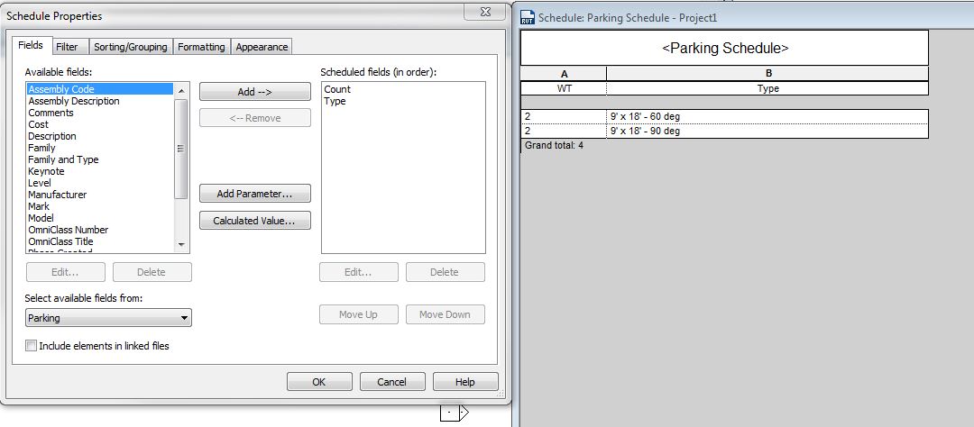

My project managet and I are trying to figure this out, but is their a way that you can total out the Compact parking spots and the Standard parking spots into their own individual totals? We want the grand total at the bottom, but we also want that to be divided out so we know exactly how many their are for each. I am wondering if that is at all possible

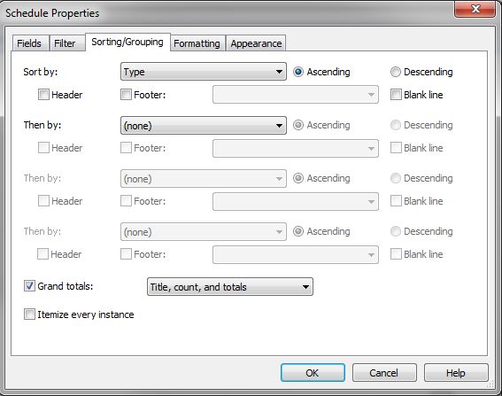

Are they different types? You could group your schedule by type, uncheck itemize every instance, have the 'Count' field in your schedule. Then you would see the count per type and a grand total at the bottom.

Your second question sounds the same as the first, so my response would be the same. I showed you how to separate them- group by type.
