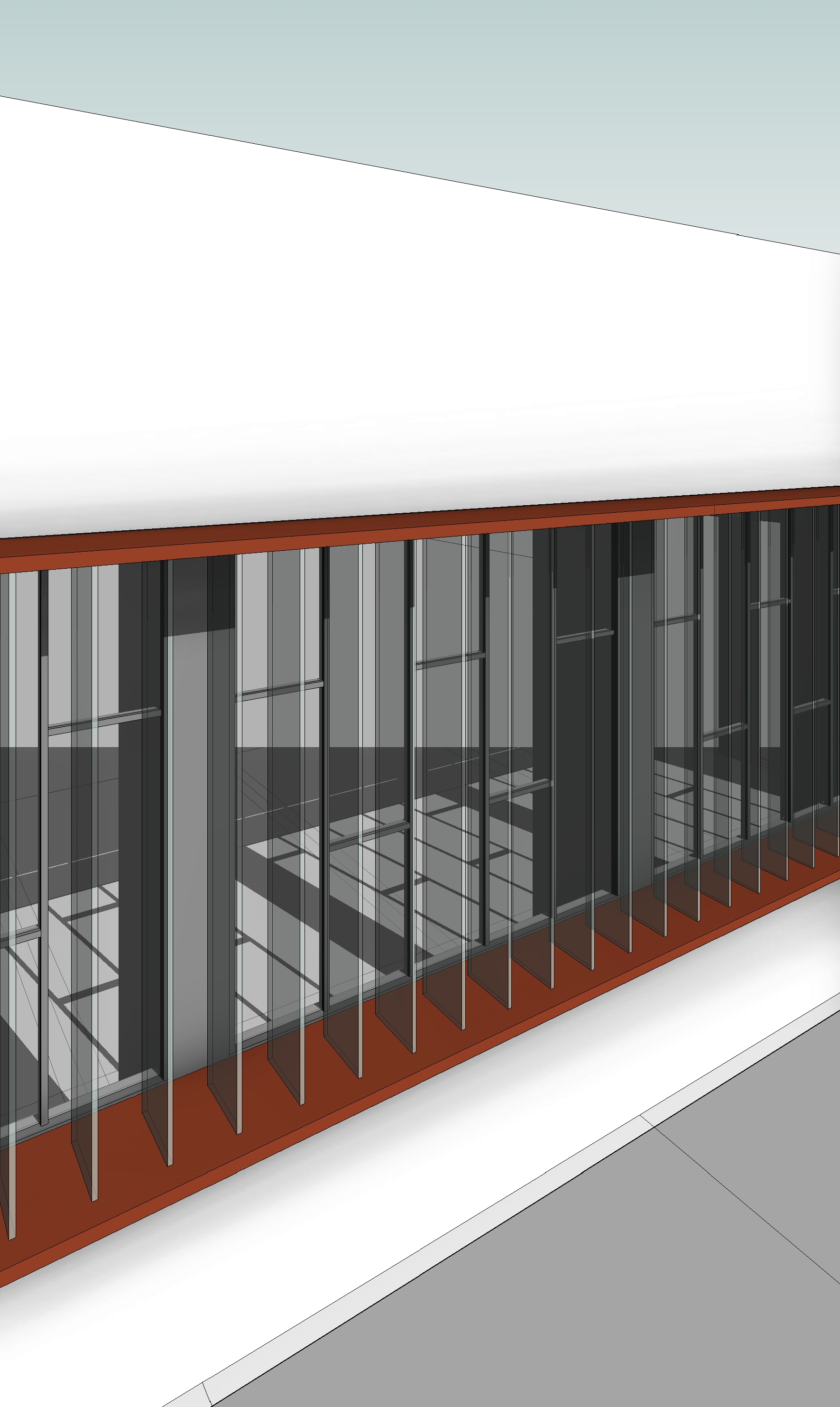

I have modelled a system of vertical glass louvers by using a curtain wall system. The louvers are the vertical mullions, made of glass, and the panels are void. I attach here an image so you can see the design clearly.
My question is: Is it possible to give to each glass mullion a different color? I would like to provide some interest to the desgn and using a range of coloured glass can be a great solution.

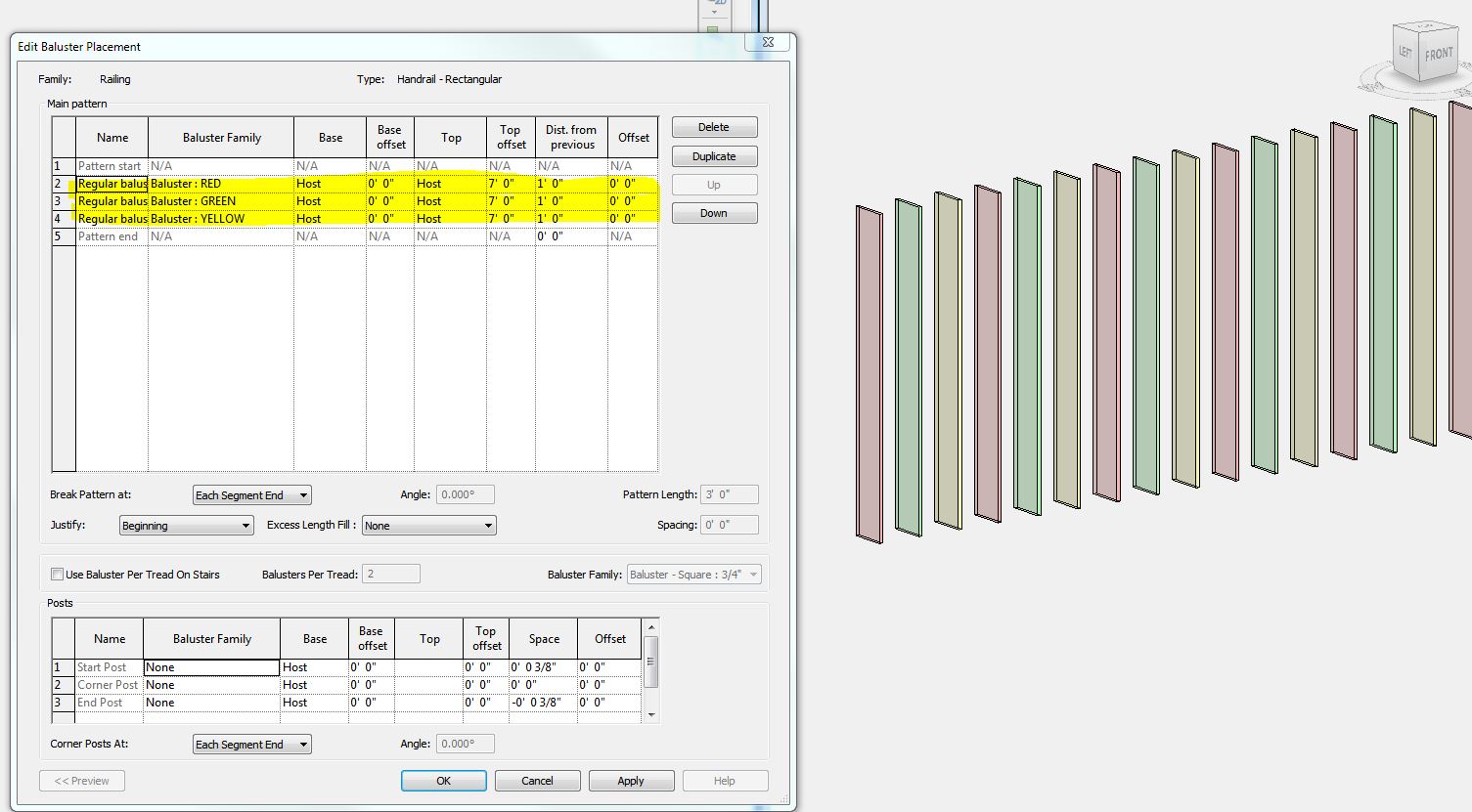

Use railing for this.

Thank you Pijpiwo!
I t seems a great idea. I'm going to try and I will let you know.
