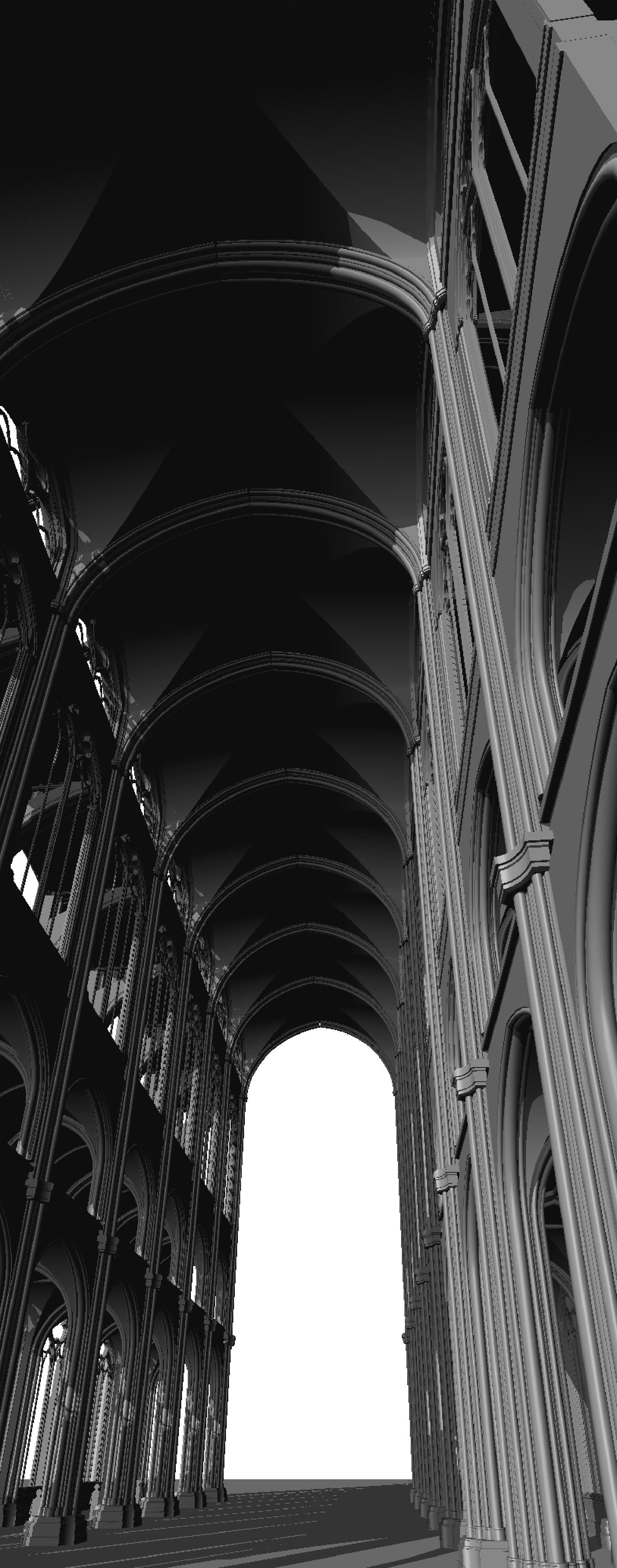

Hello - Any tips on how to create a column that isn't vertical? I would like to creat some angled columns so that it looks like a column tree. Thanks in advance.

Sorry, I replied to your other question in a similar way as Im going to answer this one... You could use inplace families, model the columns as Blends or Extrusions-and-Voids to get the column you want, then group the column when you've finished and copy the group around (so all the columns are the same). I cant rate inplace families enough, singlehandedly the coolest thing about Revit I think. When you get the hang of free modelling in Revit you can model almost anything you need (in regards to architecture). The attatched file is an exaample of what you can get up to with sweeps and extrusions...
