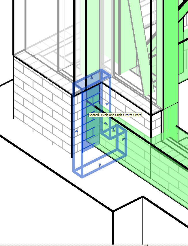

Can someone please explain to me what is happening in the attached image? I don't know where the extra shape handles have come from. The shape of the part does not reflect the profile of the wall, nor is the wall joined to anything at the top that might be throwing it off.

It’s hard to say looking at the image what the shape of your wall should be, but the shape handles are turned on and off in part properties under Identity Data.

I have turned the shape handles on for the selected part, as you can see. I want the part/wall to be just plain rectangular in elevation, but it will not let me drag the shape handles to be so.

v2013 for this project, sorry.
