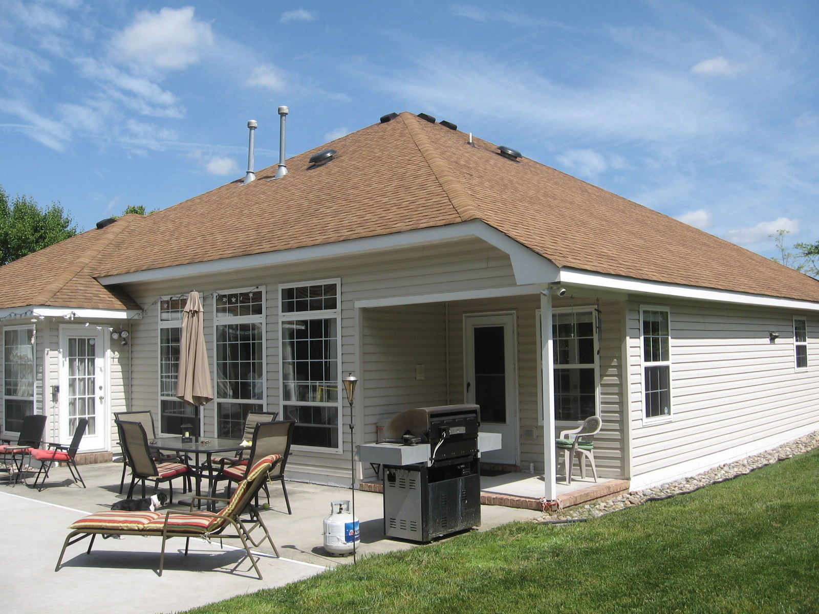

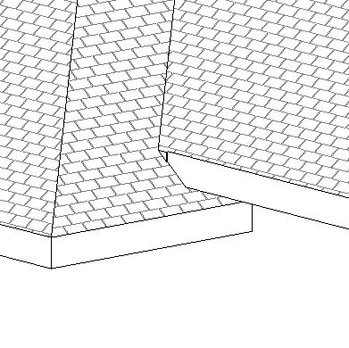

In consideration to adding an addition to this area of this house, I first need to draw the existing roof. I have tried different ways but no sucess.
Does anyone have any ideas?

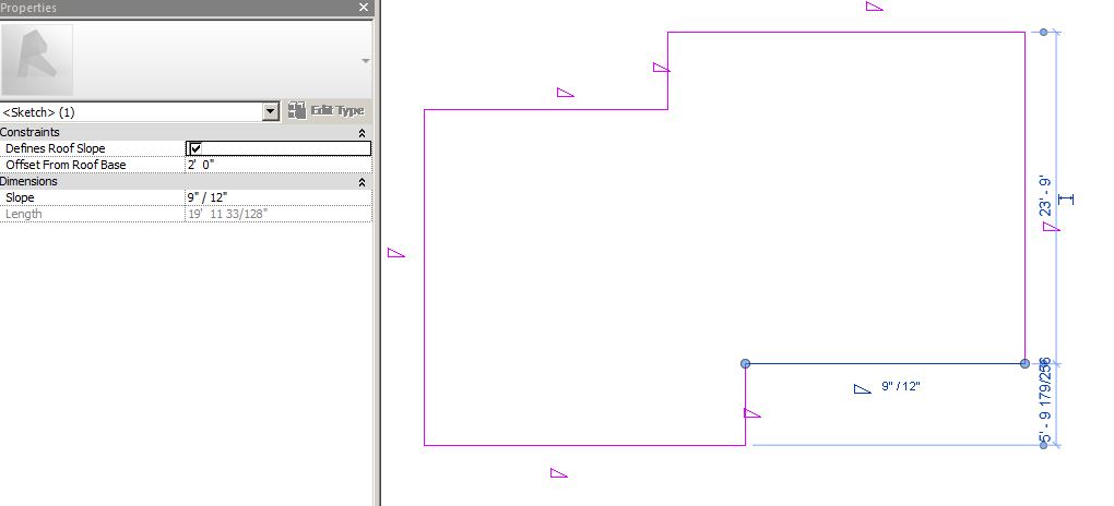

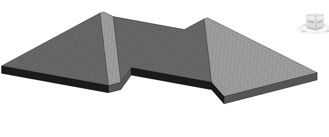

This roof is basically one roof.   There would need to be an additional small roof where the low roof in the front extends under the high roof.   Look at the attached.   To get the bump up eave just set the height for that one sketch line as I have done.

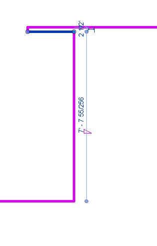

OOPS - I missed the high roof extending over the low roof.   Fixed that by adding two lines.   The small one (shown as 2 1/2" here for clarity) should be as small as revit allows you to do.
Fri, May 15, 2015 at 9:54:08 AM | Can't figure how to make this roof
Your process is somehow incorrect - look at the line's properties in my image.

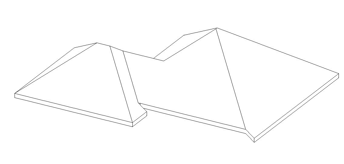

Here is my final roof with the little roof underneath and joined to the main low roof.

That little return (2 line area) may be too deep.   It can't reach the hip.   Adjust the little line moving it to the right.   You may have to play with this awhile to get it right.

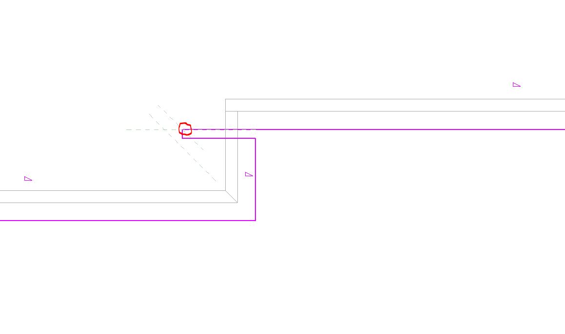

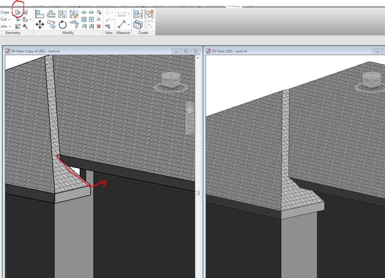

To take WW’s suggestion even further, bring this little line to the point of eave and roof intersection (pic 1) and use Join Roof tool to extend lower roof to the wall (pic 2).

First, did you ever install any updates?   There were several for 2013 if I remember correctly.  2013 was the worst Revit edition so upgrade.
Raising the line is a simple properties setting while in the sketch.  Click on the line and set the height above base << At home and no Revit so I may be using an incorrect term but it should be close to that.
Did pijpiwo post a 2013 file?   If so - open and look at it.    Nothing special except the height of the line and the trick to form the overhang.  Start without doing that and just get the raised edge to work first.

WWWHub and pijpiwo,
Want to thank you both for your help!
I did do the update and found my dashboard back to what I remember it to be.
I did look at the sketch (Didn't understsnd it was a Revit file at first), and from it I am able to understand how an addition roof would work.
I still could not make the original roof work like you guys have. I tried all kinds of different pitches, adjusted the litle gismo, raised and lowered different walls ect. It probably has something to do with my need to use a 4" wood stud wall with siding and maybe the template I have setup.
Anyways, I do feel I can now draw the final project, due to your help.
