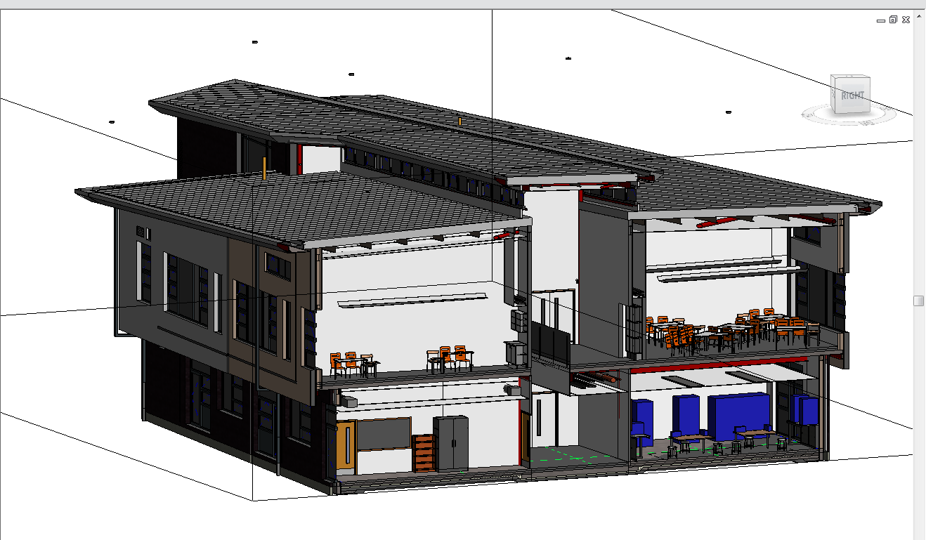

Im currently working on Revit MEP 2015 and have been asked to create a series of 3d sectional views for a brochure highlighting our ductwork and electrical systems against the building model.
How do i adjust the transparency of both the linked building and structural models to say 50% when creating these sections so the MEP systems show more clearly?
Ive clicked on the linked models - overrides graphic in view - by category - surface transparency - option but it hasnt worked. The linked models stay the same. Please see attached dwg.
Any suggestions please?
Thanks
Andy
Wed, May 13, 2015 at 10:59:47 AM | Setting Transparency to a linked model.
Simple:  VG Tab/Revit links tab/basics pick custom / model categories tab - pick custom /select all categories the set the transparency.
Thu, May 14, 2015 at 3:06:09 AM | Setting Transparency to a linked model.
AndyRH
Joined: Fri, May 2, 2014
0 Posts
Thank you WWHub. Worked a treat.
