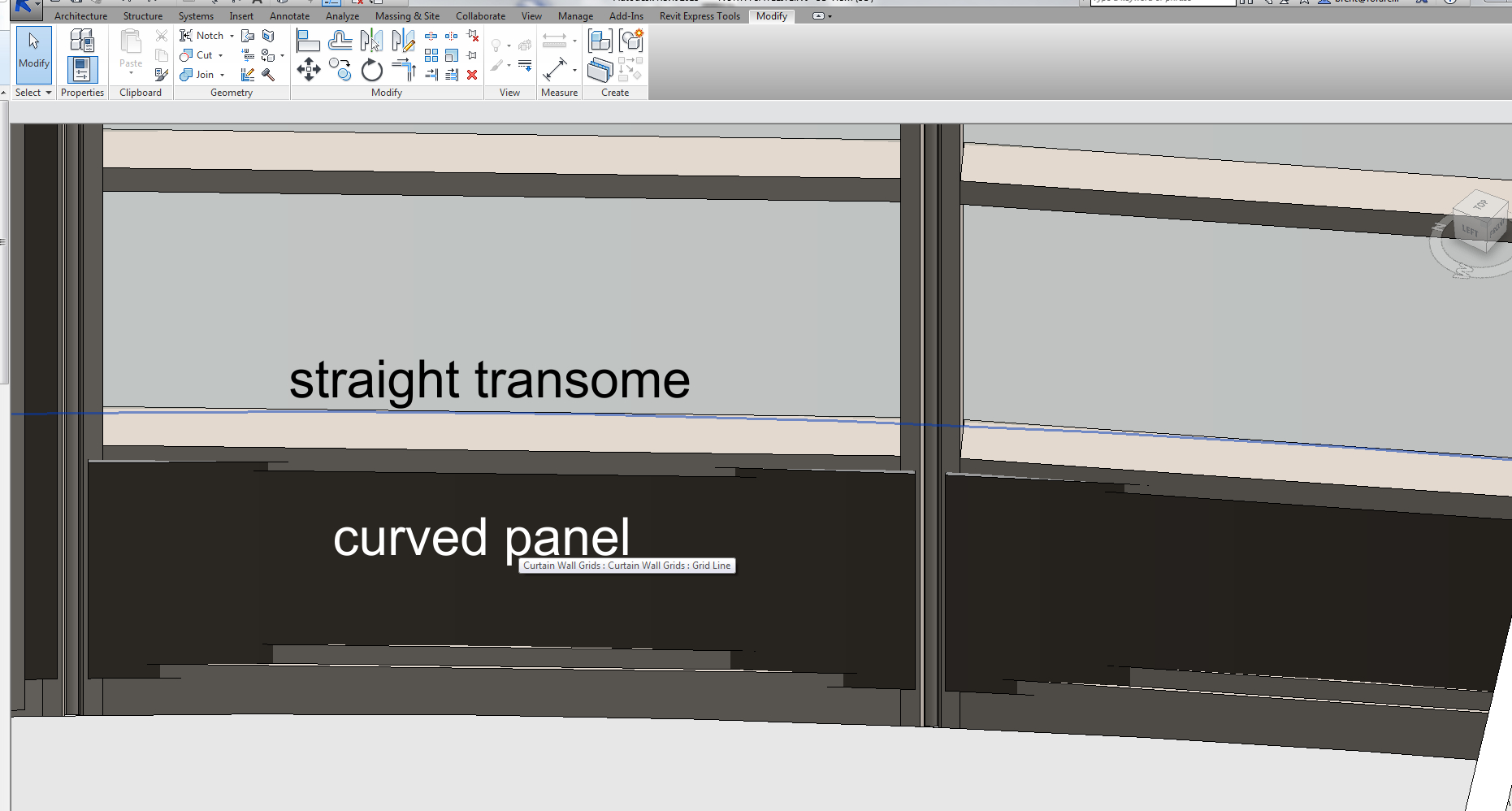

Hi,
I have modelled a curved curtain wall system.  The transoms are segmented (straight) between millions,  though the panels remain curved concistent with the radius if the curtain wall.  Is there a way to get one or the other to be consistent?
Regards
Brent
Tue, May 12, 2015 at 7:40:25 AM | curved curtain wall, straight transoms, curved panels
Standard panels do not curve just like typical glass and mullions do not curve.   You will have to use special families for the glass or even easier, use your own model elements rather than curtain wall ones.

Hi WWHub,
Thanks for your reply. Panels in the curtain wall were walls themselves. Changing them back to system panels straightened them out.
