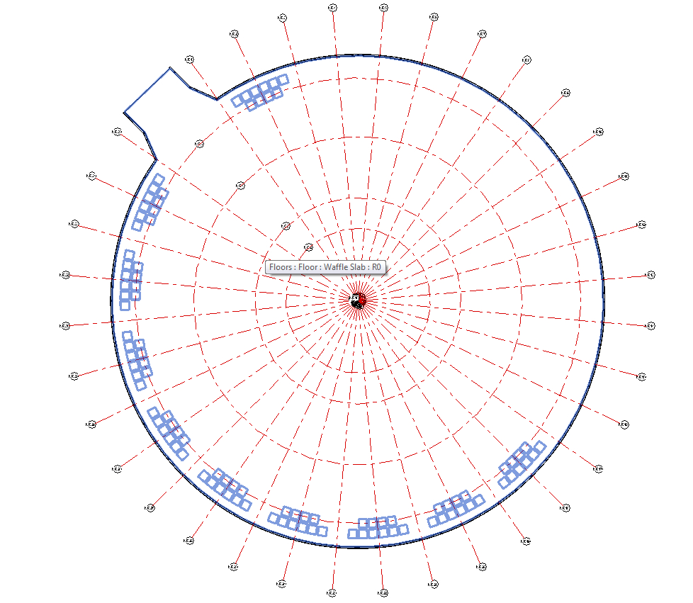

Hi,We are doing some work to an existing circular building with radial grid lines. See attached plan showing grids.    When viewing elevations the grids do not show because the view is not perpendicular to the facade.  Is there a way to view the entire facade as a true elevation?
RegardsBrent

"True elevation" is what you get from Revit but you don't want that.
There have been discussions here in other threads about this but I only found one:
http://www.revitcity.com/forums.php?action=viewthread&thread_id=21990
