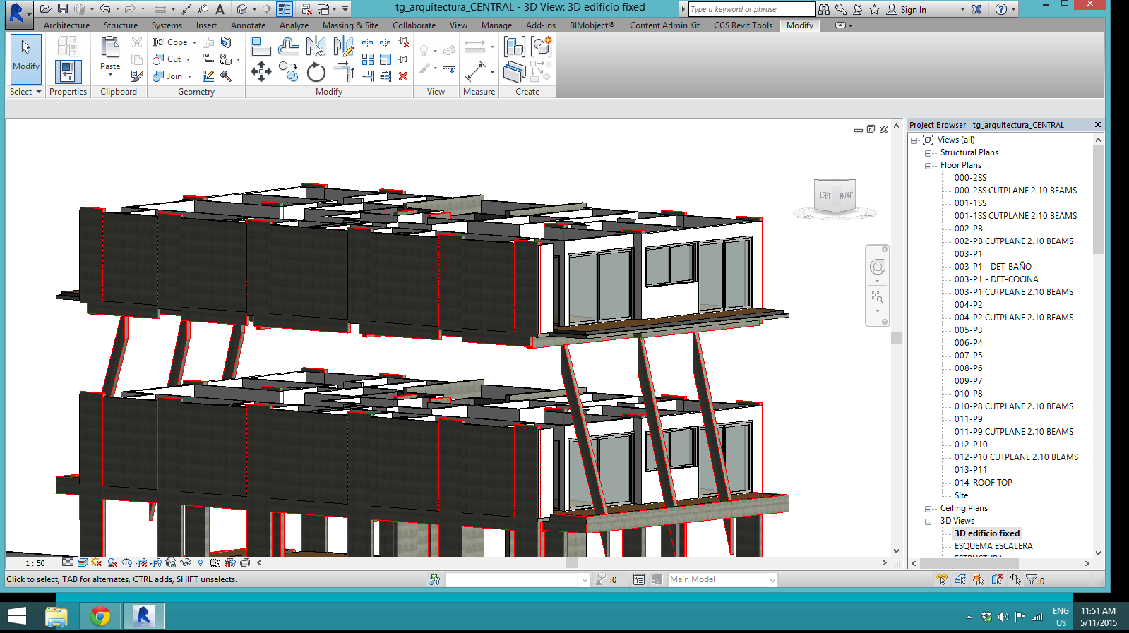

I have a issue, maybe a dumb one but i cant figure out how to copy correct a structural framing from one floor to another.
im try copying everything to the clip board and pasting it with aligned to selected levels, the problems comes with some beams that cant be copied and some others remains attached to the lower floor.
Mon, May 11, 2015 at 10:20:58 AM | Copying Structural Framing to Other Floor.
That image doesn't help much.... you need to explain more.
Are those sloping beams?   If so, then they may be part of the problem becanuse they may need a support first.
Try being more selective in your set to copy reducing it to same type elements leaving items like the sloping elements until last.

no its not an sloping beam.
i dont know but its a weird behaivor of revit.
i cant copy the entire floor in one step, i figure out that i need to copy firts some Beams, then the others one, then the floors, then the walls
i need a lot of multiple copy from floor to floor to avoid missbehaivor of the program with some elements.   its really time consuming
