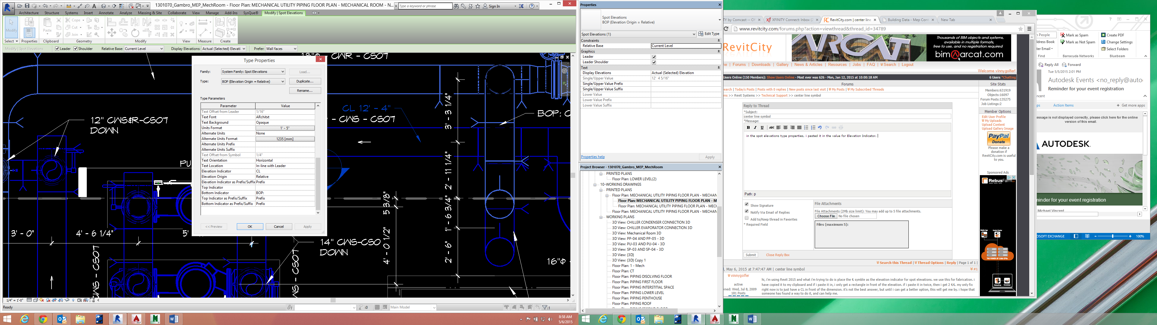

in the spot elevation type properties, i pasted the symble in the Elevation indicator value box. that way it appears in front of the elevation text. i attached the screenshot to show you.

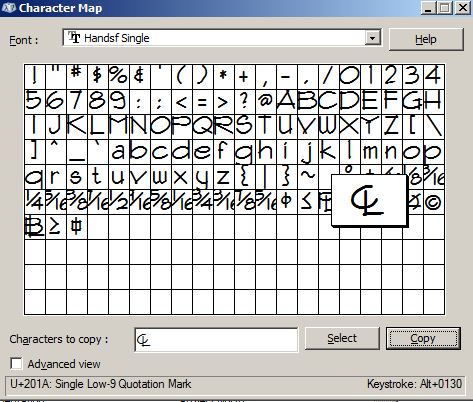

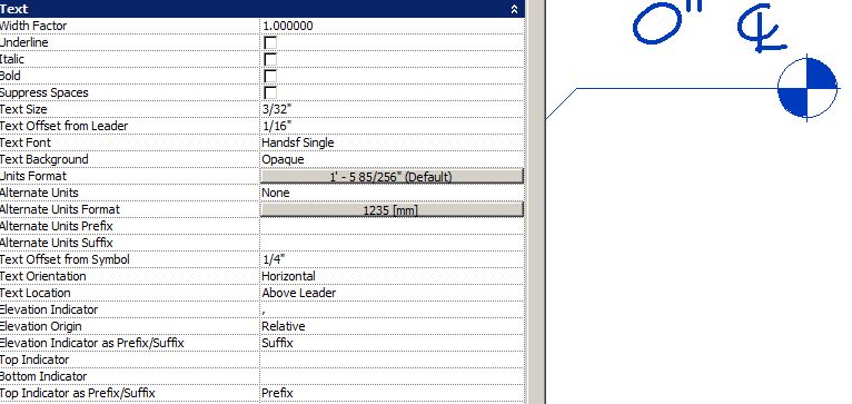

When you do find a charset that has a CL as this one does, it will not show the correct character in the type propertise.  In this case, it showed a comma.
