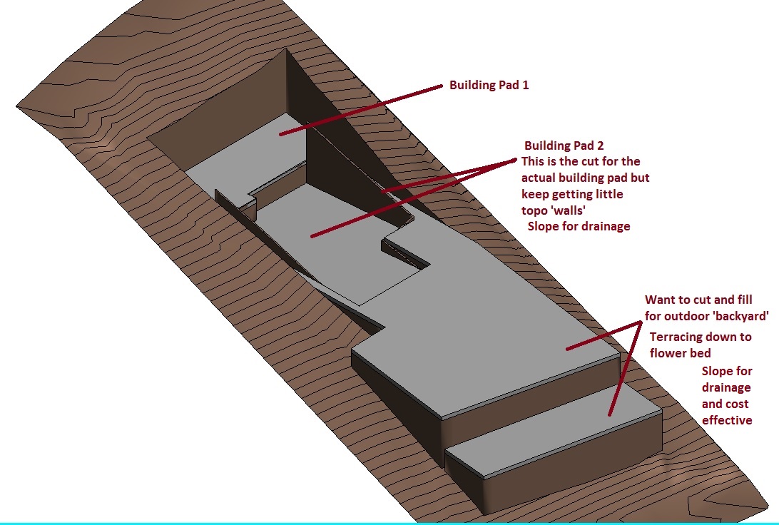

Hi all,
I'm on Revit 2015,  I've only seen this issue addressed with adjacent building pads but not with inscribed building pads.  I always get artifacts of 'topography walls' no matter how I set up the level's constraints.
Wed, May 6, 2015 at 7:25:40 AM | Sloped inscribed building pads have topo 'walls'
The edges of the pads MUST be at the same EXACT position.   I copy the sketch for the adjacent pad and paste that into my new pad sketch using the linework I need.
