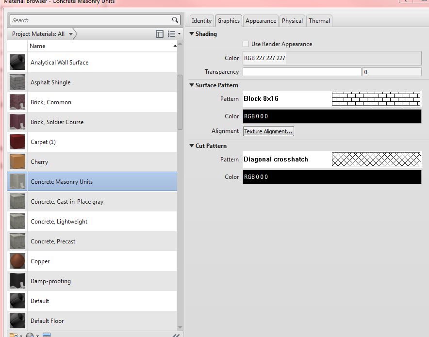

I cannot seem to find a CMU wall.  It seems like I should just be able to go ahead and laod one or else duplicate an existing wall and change the material to CMU with the CMU pattern in elevation view.  I cannot find that hatch pattern either.

Using help is not really the problem.
When I click the wall command, there are no choices for CMU.
When I create a wall then edit the type and duplicate and call it CMU, then go into the structure of the wall and the material, there is no option for CMU anywhere.
I recall seeing CMU walls (in the 3D view) on earlier versions of Revit Structure.  But as I search through the entire program and libraries, there is no CMU wall or even a CMU material with that pattern.  Revit has the CMU cut pattern, but not the CMU surface pattern.  Seems strange to not be able to create a CMU wall.

 I opened my revit 2015 otb and in the wall types there is exterior cmu w/ furring or brick, etc... Just duplicate one of those and nuke the furring. When i open my materials list, concrete masonry units shows up
