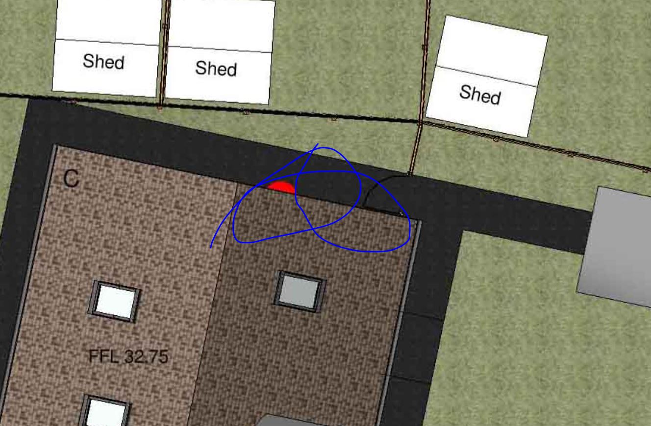

Hi,
Im currently using revit 2015 and when rendering I get red dots appearing but only in the rendered views (As the attached image).
Does anyone have any clue what they mighht be and how I can resolve the issue?
Thanks in advance.
Jgmacdon.

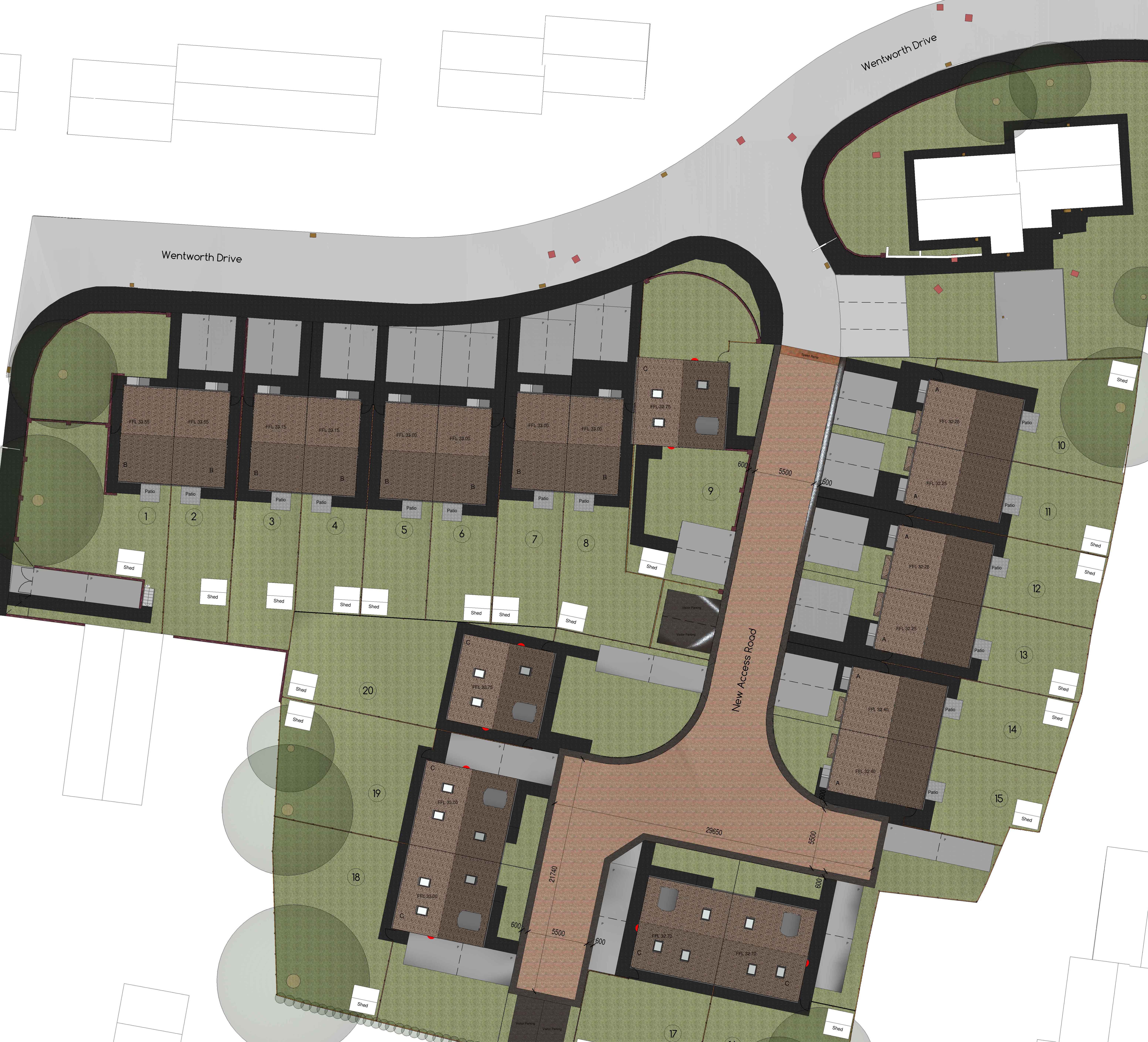

If by red dots you refer to the ones on the outside of the buildings. (See screengrab), they look like externally mounted walllights. Select one, choose select all and hide them in view.
