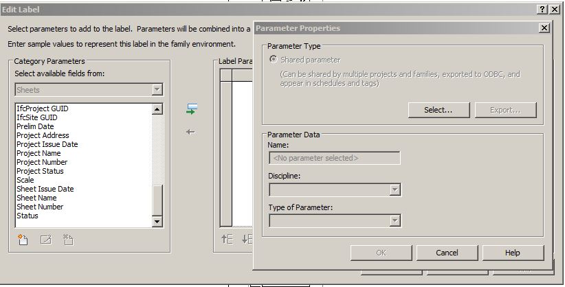

Hi Revit Experts,  I am trying to add a shared parameter to my title block family, just a sheet title that can be transferred to other projects. nThe 'Shared Parameter' option is grayed out when I try to add the shared parameter throught Family types.  I know this is possible, howerever my research has led me to a list of family categories that allow shared parameters, and Annotation is not one of them.
I am certain this is possible... What I am I missing?  Any direction would be helpful.
thanks
Rob
ronario
Mon, Apr 27, 2015 at 8:01:45 AM | Shared parameters for title block
Start your label then when the edit label pops up, select the lower left icon which allows you to add a shared parameter

got it! I appreciate the help
