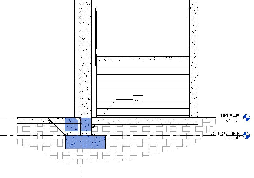

I have a tilt concrete wall panel that goes to T.O. Footing and stud wall that stops at top of slab. It's a single wall assembly with different lengths at the bottom of the wall. When I create footing for the wall, Revit automatically creates two footings, one for the stud wall and another for the tilt panel. Is there any way to delete one? If not, is there a workaround? Thank you.
Attached is a photo in which I highlighted the footings. It's a single component.

As far as I know, there is no way of correcting this short of using two walls.  I would probably define this as one wall that is the concrete and the other is the reast of the wall.  After placement, the two walls can be joined.
