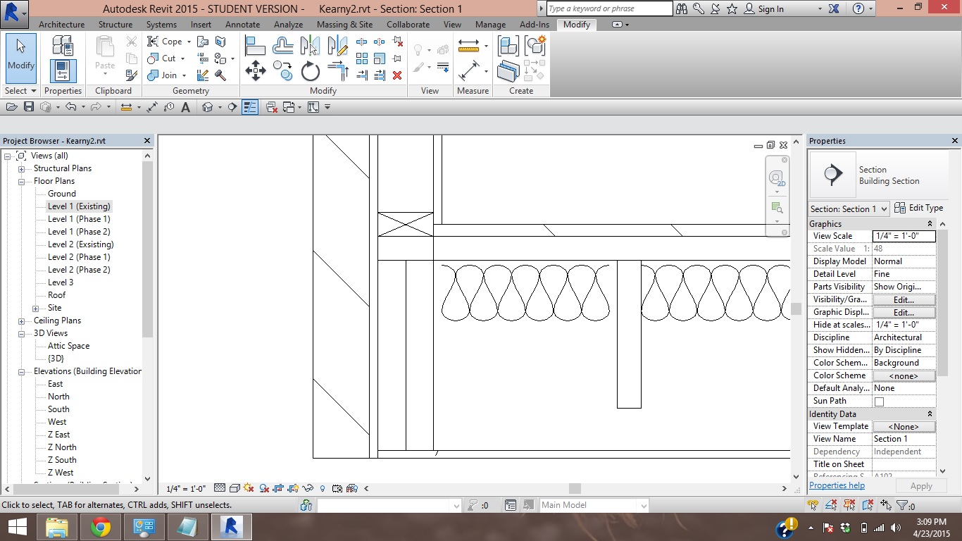

How do I extend my floor plywood layer into the exterior edge of of my wall studs? I have the floor core and bottom layer extended to where it needs to be just not the second plywood layer.

I figured it out. I simply had to add the plywood layer to inside the core boundary.
