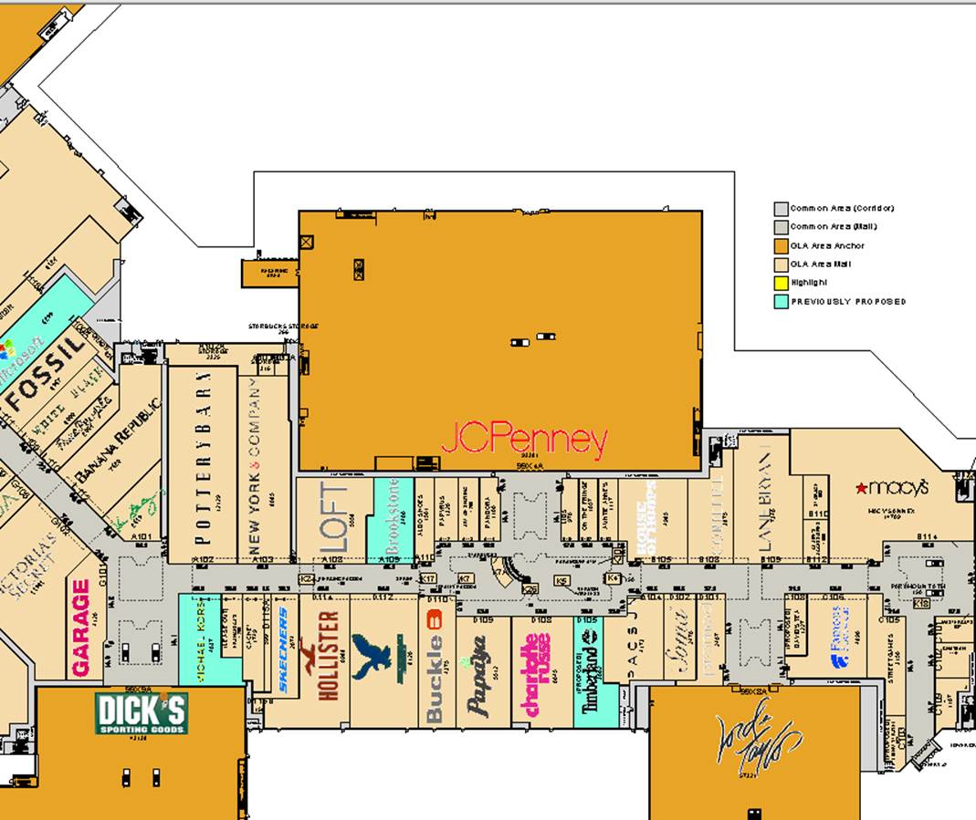

Is there a way to show only one value for a color fill legend? I have my color fill legend reading off of the "Department" value on the rooms. Please see attached photo (sorry for the low quality).
Our default plan for leasing shows the colors for GLA Area Anchor, GLA Area Mall, Common Area (Corridor), Common Area (Mall) and Highlight all the time. This particular plan is unique in that the rep wants to show previously proposed spaces highlighted in blue- and I only want the color legend to show this unique value for Previously Proposed. Is there a way to only show one? I know you can make it show all available values, but I want the opposite.
For a quick hack to get the plan done I had my Operator do a filled region with text, but if we change the color then we also have to change that. I'd love it to be automated.

You might want to add another field to your rooms then use that field for your colors.

Wouldn't that be another color scheme? And can't you only have one on a view? I still need to show the rest of the colors on the plan, I only want to show one on the legend.
