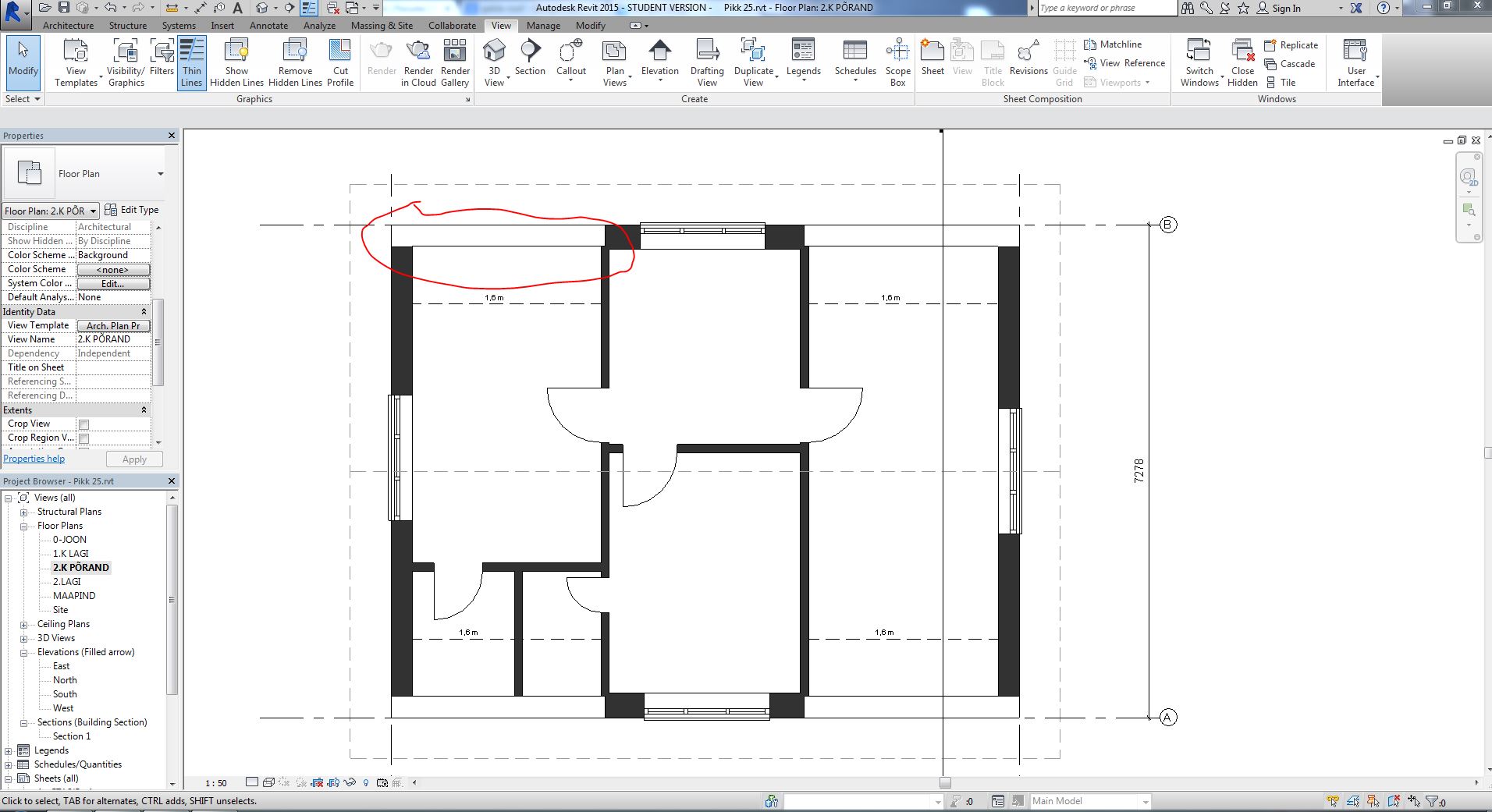

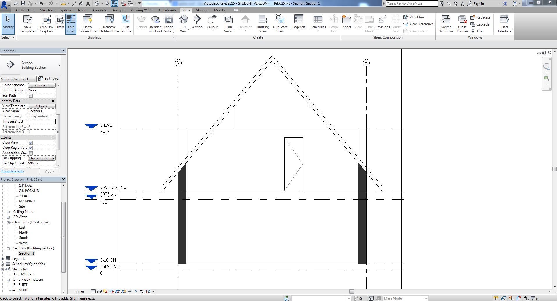

Thing is, I'd like to present on a 1st floor plan view with all the walls and windows (in coarse) but it's a gable roof and when I adjust the cut plane to cut the windows, walls become hidden under the roof even when hidden.
The windows sill height is around 900mm, but roof cuts the walls at 700mm so they become hidden in plan view. I'd like to see all the walls in dark grey color and windows as they are.
I hope I explained myself right. There are 2 pictures as well.

Those walls are no longer being cut by the cut plane.   Learn to use a plan region to change the cut plane at an area of your plan.  It is under the plan views pulldown.
