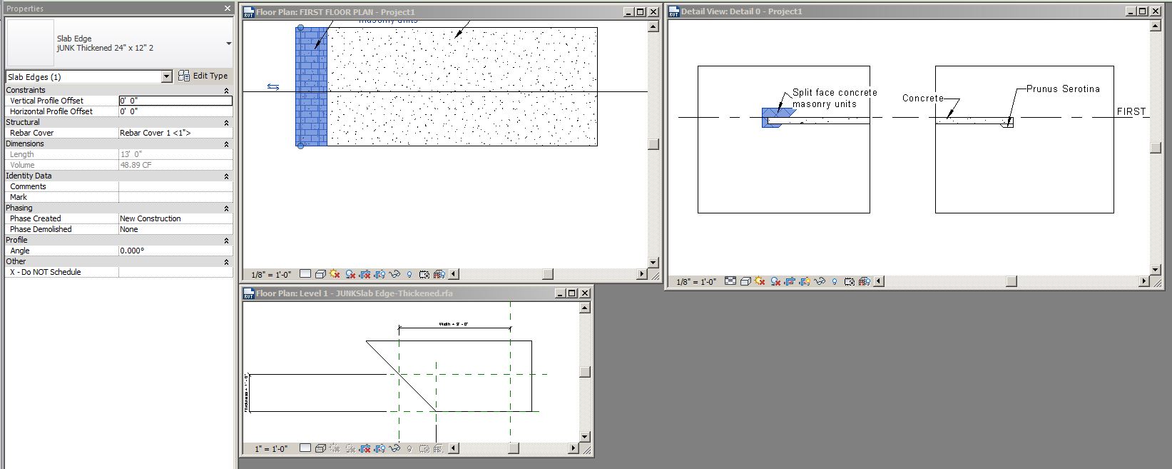

i have a materal tag that used on a 2nd floor plan (works great)
but when i try to use the materal tag on my foundation plan i does not show up.
i've check all setting i could think of. anybody have a idea?
Thanks.

Thu, Apr 16, 2015 at 2:17:58 PM | Material tag not tagging!
You can tag it in plan because you can see it!  You have to see the material and slab edge profiles are typically placed under the slab.  Here is a slab with a standard slab edge on the right.  You can tag it in section but not plan.  On the left is a junk slab edge who's profile makes it come above the slb.  You can tag it in section and plan.

I understand that but the material tag will not even tag my wall or anything in that view. in the visibility/graphics box that material tag is checked.
!!!!! I fixed it but not sure how? i set up a foundation plan view template and a mezzanine plan view template when i started this job so im my foundation plan i switch the foundation plan view template to mezzanine plan view template and it worked. i have a box check somewhere in that template that i can not find.
thank you for your help.
