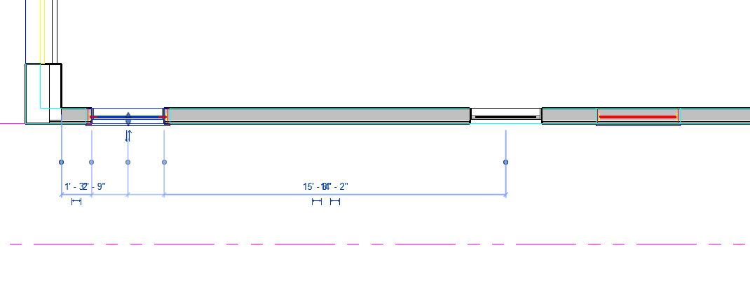

So this is now standard on my view. this happens everywhere. not isolated. does anyone have this problem or fixed it? the temp dims all overlap and are unreadable and sometimes unclickable. see pic.

I'm not having a problem but my Temporary dimensions measure from Walls-Faces of Core and Doors and Windows-Openings.  What is yours set to?

Well shoot that was easy, just changed to opening edges not centerline, which fixed it. Funny, I thought this was already set the first time. Gremlins meesing with my settings.
