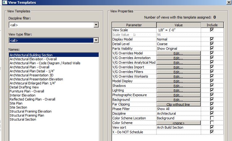

I created a plan callout detail view on my floor plan, using callout. But it is showing up under the floor plans in my project browser, not under the details views. How do I change it?

The view will be placed automatically in the same folder as the plan that it was created from unless you have a view template assigned that will place it elsewhere.

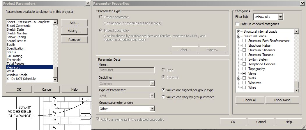

I could not assign a view template, as in the view template it does not allow me to assgin views
Thu, Apr 16, 2015 at 1:48:04 PM | plan callout showing up under Floor PLans in project browser
Well - Then fix that!
Look at images below
Project parameters ..... View template
Missing Callout Head & Floor Plan Sorting
