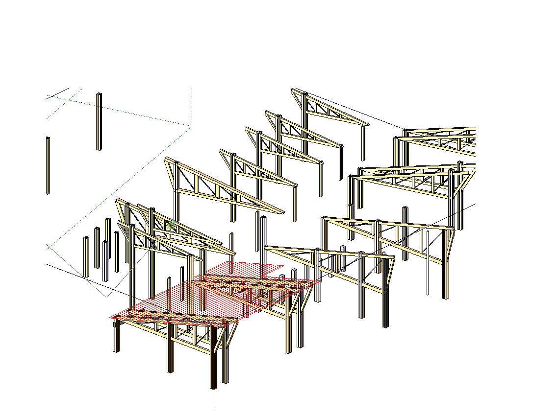

I've placed a beam system in my project but am unable to see it in any of my views, including 3D. I've checked the view visibility settings, the beam family visibility, I've tried changing the type of beam, nothing seems to affect it. I can select the system in plan, section and 3d, but am stumped on making it visible. Any suggestions??? I've attached an image of a 3d view with everything turned off aceept structural systems, columns and framing, with the beam system selected.

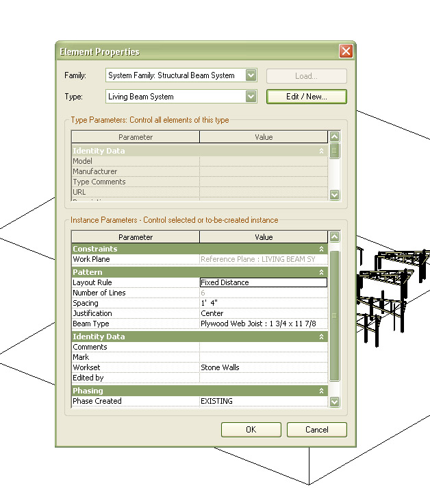

What are your "Structural Beam System Properties"?

Here's a screenshot of the element properties. The reference plane is one that I created to match the slope of the roof. Since the original posting I've created a second system, just to see if the visibility was a fluke, it wasn't.
