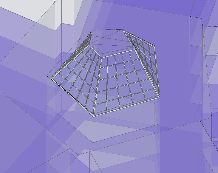

Greetings group,I'm trying to mass model a building in the shape of a star/pentagon. it consist of a void capped with a skylight. i managed to model the void but i'm having problems modelling the skylight above for the analysis.Any recommendations?The following model shows what i have achieved so far:https://app.box.com/s/w9aq9uzmz1o39rktzsgsvo6z4onryrzdAnd this is a picture to show how the area is intended to look:https://app.box.com/s/zkultkjbd8x2vfj1j2cxmy9q2e6qefst

Just create a seperate mass there and create a roof by face - sloped glazing. Then turn off that mass.
