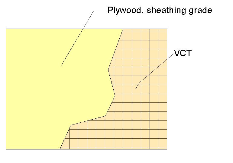

You are the one using rooms to do this - so your only answer is rooms (if you want an area).
We often split the finish surface of floors (or add a thin floor) to show different materials.  That material can be tagged and the material area can be scheduled but not by room.
