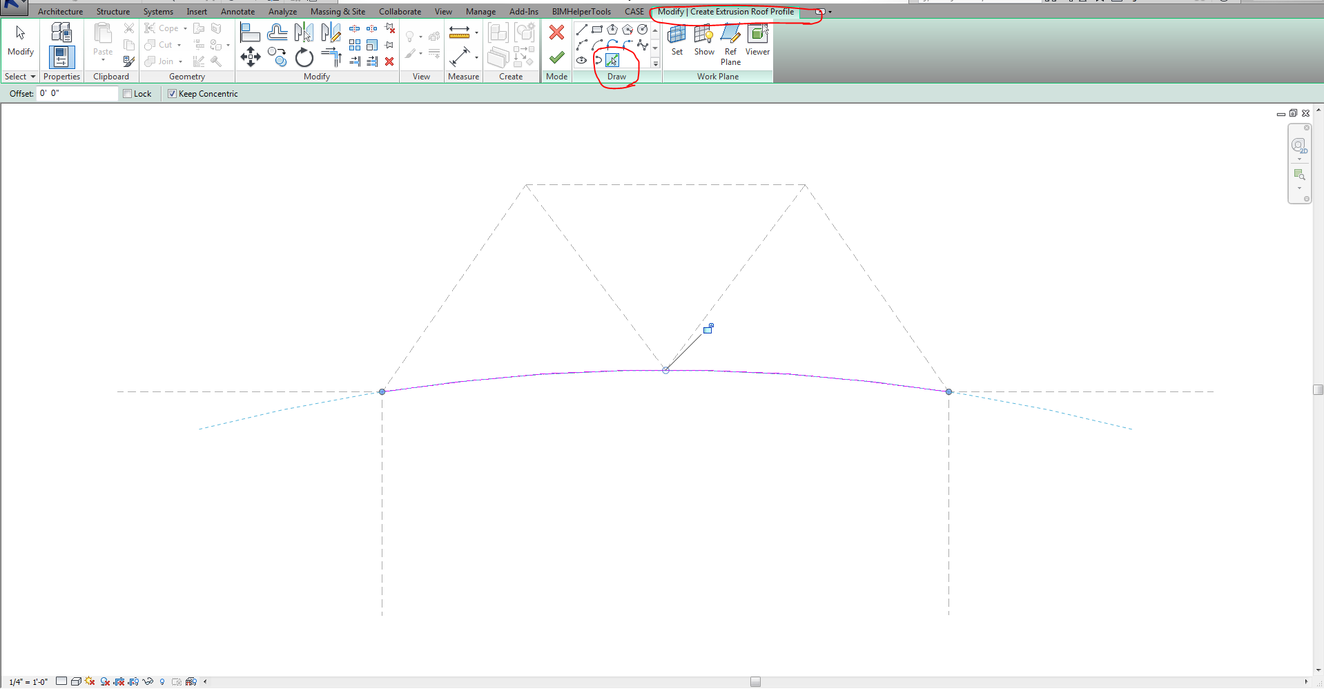

I tried using floors but cant get them to follow a curve in the horisontal plane.  any hints on how to make that?
Mej75
Thu, Mar 26, 2015 at 7:50:18 AM | Arch bridges.. HELP please..
revitape
revitape Avatar
Joined: Tue, Nov 13, 2007
111 Posts
4.5 Stars: 9 Votes

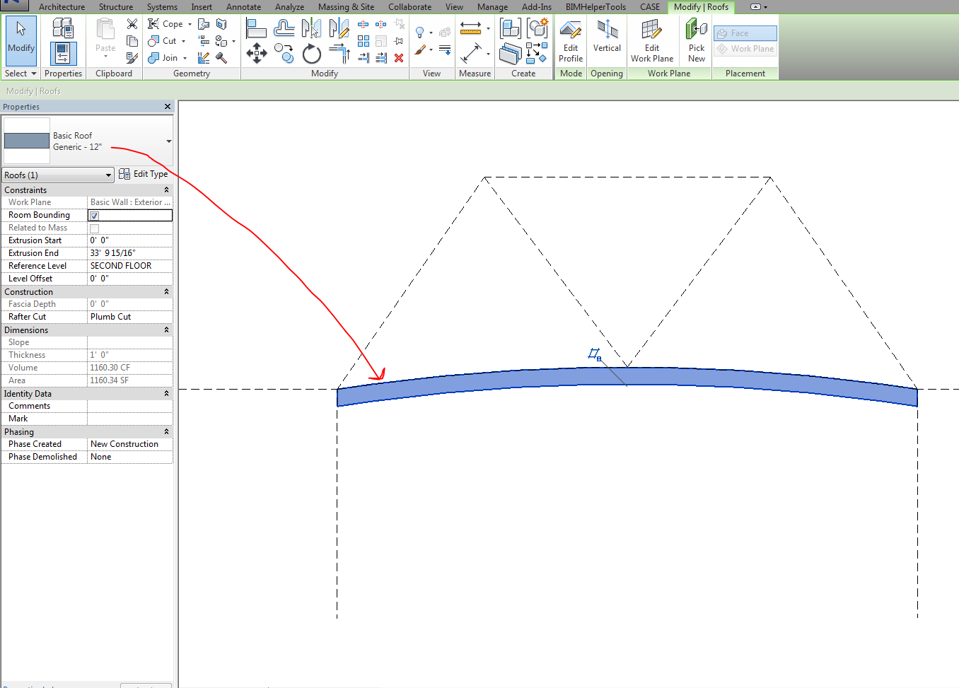

For the curve roads... you could do an in-place family and model a simple extrusion in the shape it needs to be. A better solution may be to do a "roof by extrusion" though. If you already have the arc shape, you can use the "pick line" tool and also your thickness will easily be established by the "Roof type" you choose.

Here's some images...

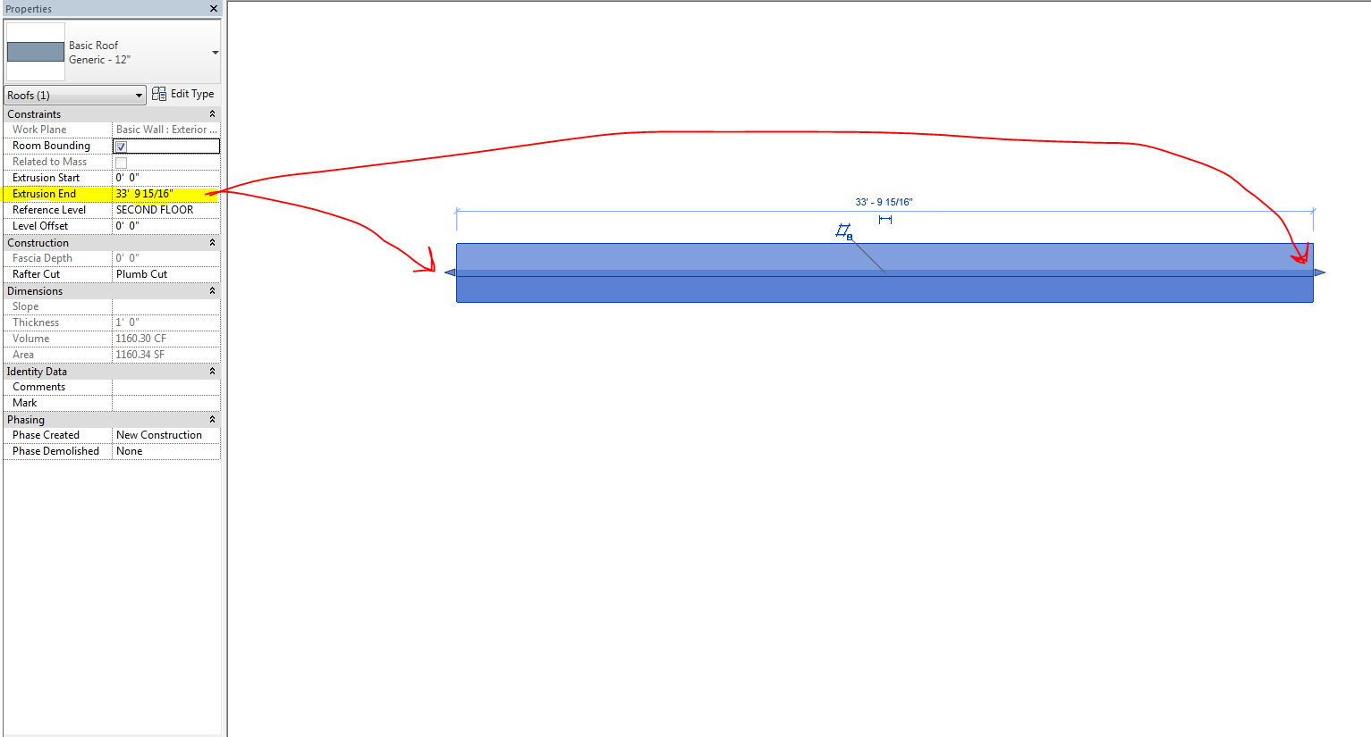

If you aren't familiar with Roof by Extrusions... this is one of the few times in Revit where you will be in sketch mode and not actually make a closed loop. That is because the thickness of the roof is established by the roof type as I mentioned. So simply pick or draw the shape as a single (or chain) of lines and then hit finish!

I kinda rushed the answer but the best way to do it is this:
1. In plan view draw a reference plane and name it
2. Go to an elevation or section view and choose Roof by Extrusion
3. When it asks what work plane to extrude from, choose the one you drew
4. Make the shape
5. Finish
6. Control the width of your "Road"(roof) in the properties (or use the grips- which is a less accurate way)
Let us know if there are more questions, good luck!
