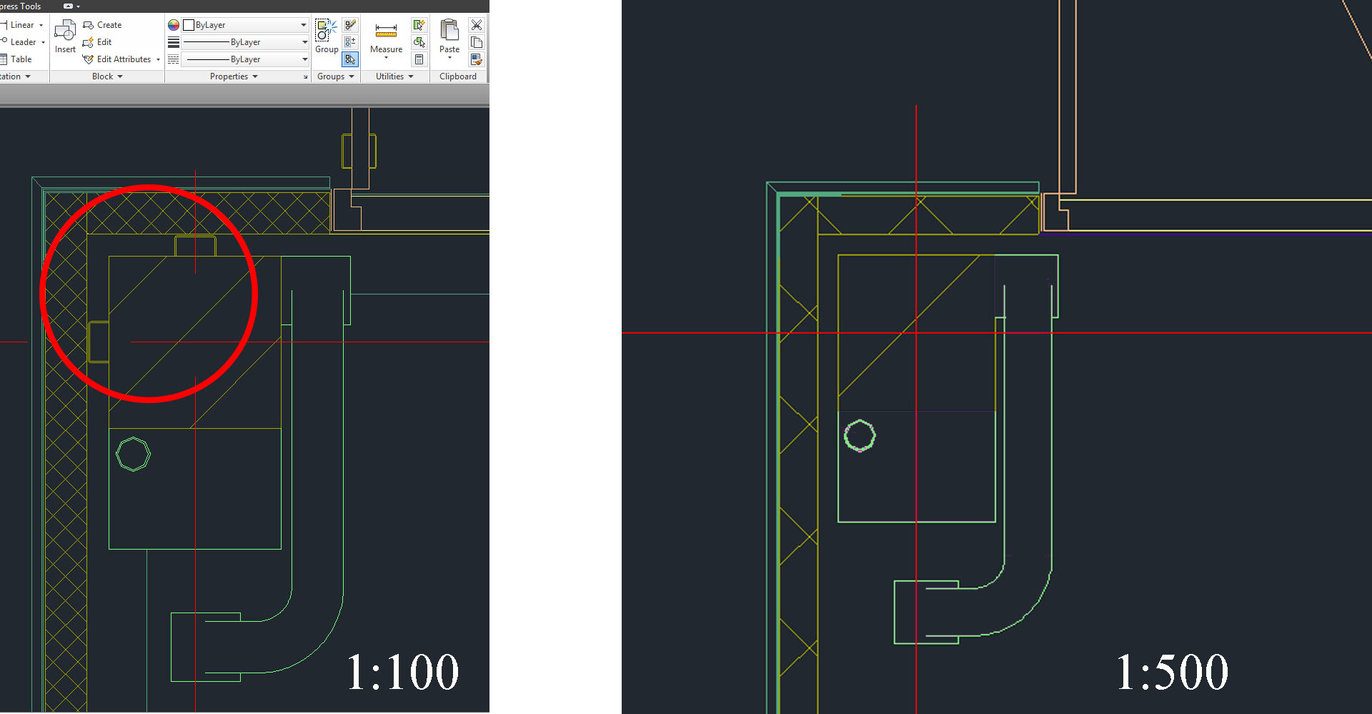

Hi!I'm using Revit 2014 and I have an issue with exporting small objects. When I export to DWG a sheet with a view placed in it (with a view scale of 1:100) everything is ok. All objects appear and nothing is missingWhen I export the same sheet with the same view but this time with scale 1:500 some elements went missing. Probably in the export process Revit omits small object (I guess)I've attached two screenshots to illustrate the problem.Do you have any idea what could be the problem and how to solve it. Is there some kind of a setting which controls the precision/scale thing.Thanks guys!

There is no problem here.  When lines are too small, Revit will not display them.  That is really not a problem.  Just because you can zoom in and see them in CAD desn't mean they need to be there.

We are talking about different issues her.  Revit is very accurate!  Revit is not CAD and does not work the same way and never should.  When you export to CAD, you are creating a 2D document and Revi's 2D rules apply.  Here is an explanation from your HELP>
"Adjust the view scale to control the precision/performance ratio.
When you export to 2D DWG or DXF, you export a scaled 2D view of the model. The view scale you apply determines whether the resulting view is exported for precision or for performance. For example, if your model contains 2 lines that are 1/4" apart and the view scale is 100, the lines will be considered to be within tolerance, and the exported DWG will contain a single line (exported for performance). If the view scale is 20, the exported DWG will contain separate lines (exported for precision)."

Finaly, I found out a solution. The problem was that in family, in visability, the Coarse was not ticked. As far as I ticked it, everything is ok.

Revit is a complicated program and with some user issues, we can't always point to what may be causing a problem for the user because we just don't have all of the information.  I would have never come up with this being a family issue from your original question.  My assumption was the missing linework was there and not being exported but now we know it wasn't there....
