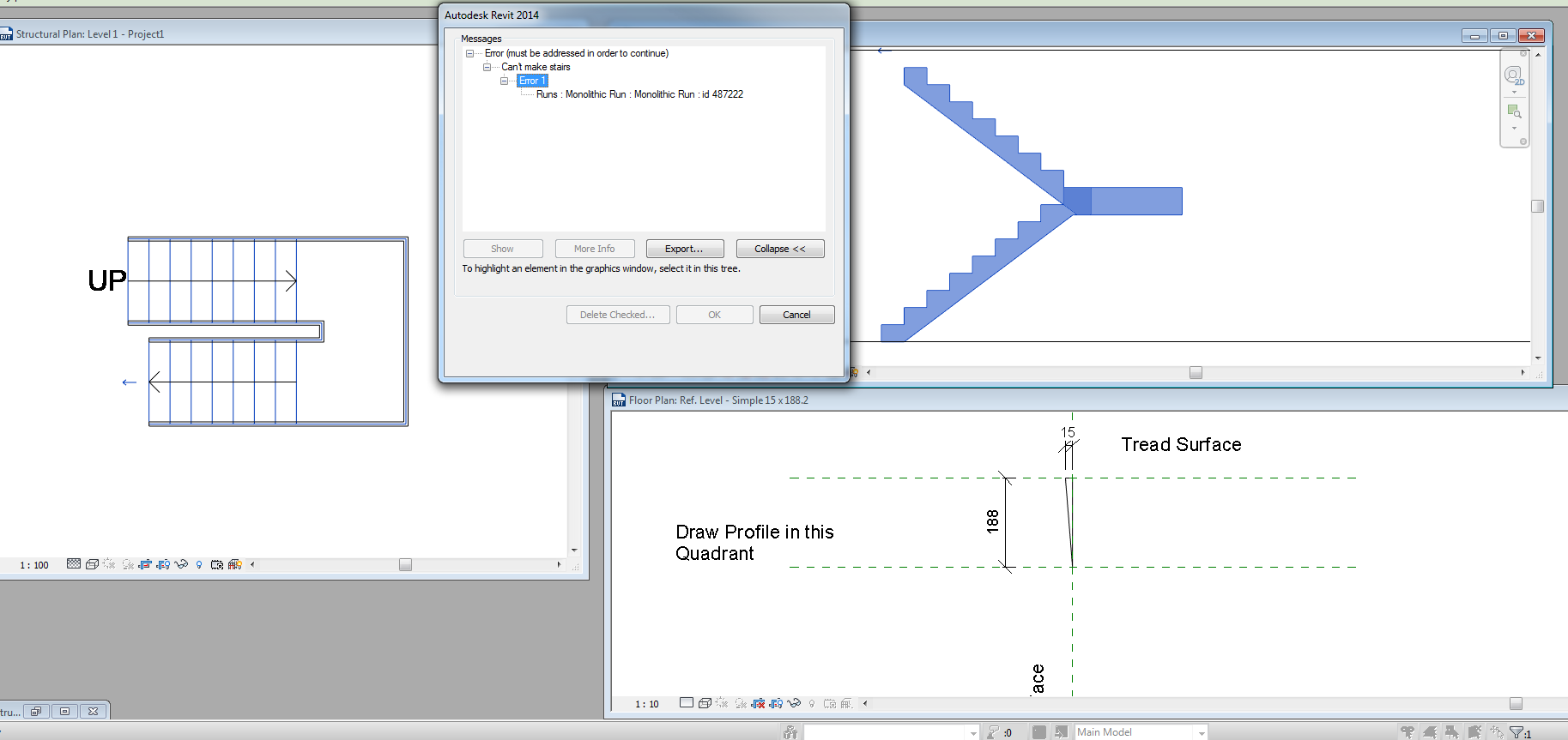

Trying to add a simple stair nosing profile to a stair. 15mm x (Riser height 188.2mm)
When i try applying it i get error "can't make stair"
Runs: Monolithic Run : id 487222
It's a cast in place stair, Profile i drew to the size required for this stair. Can it be more generic so i can use the same profile on other stair's that are different to 188.2?

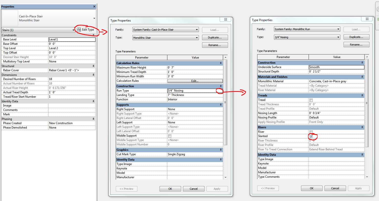

Are you trying to create slanted risers? Why not just tick ‘slanted’ option in stair type properties, instead of applying this profile to the riser?

yes thats what i was trying to do, i thought it should have been as simple as this but didn't find it.

See picture.

Thanks for the Picture, as soon as you mentioned the slanted tick box i found it.
