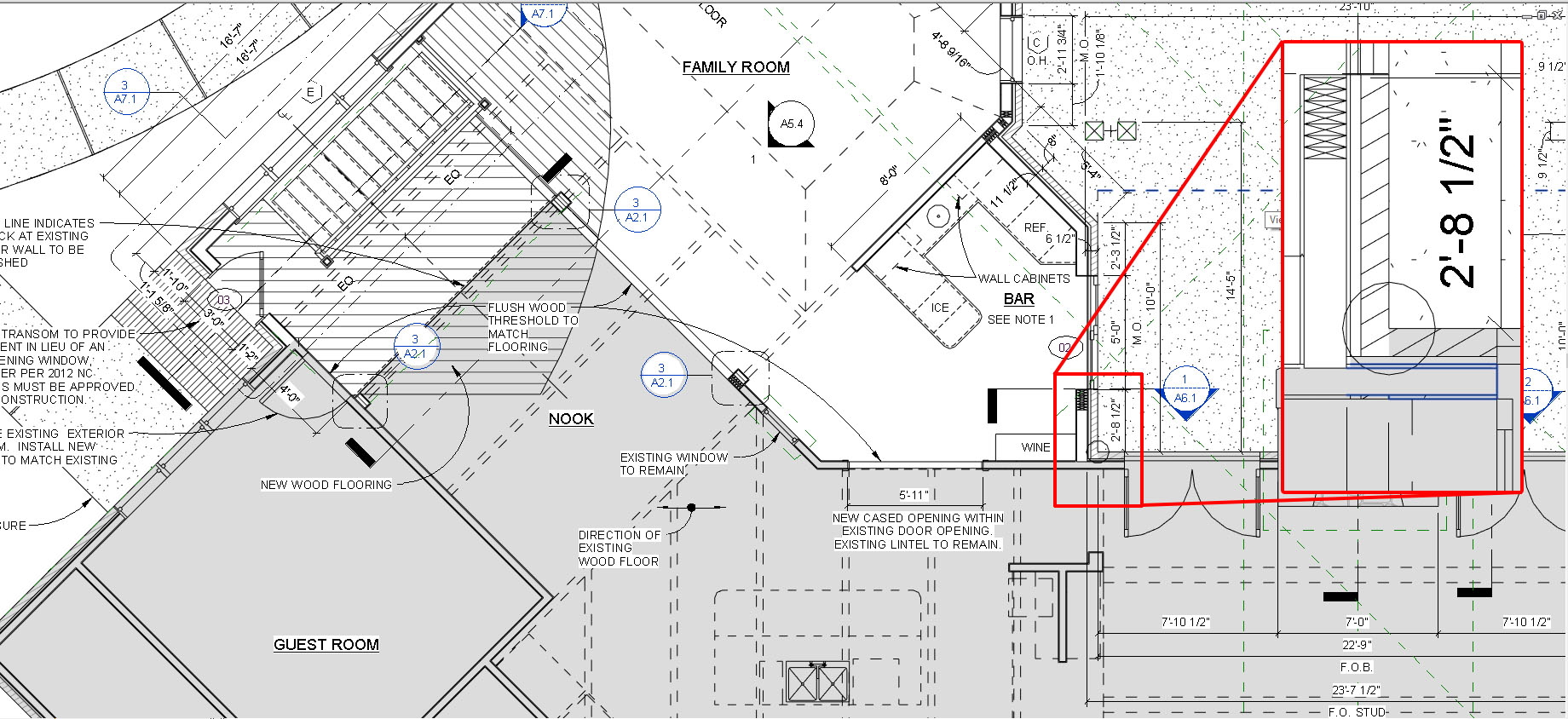

We dealt with this on a renovation of a house.  We created a large filled pattern that traced where the existing house was and was not being touched.  We still wanted the exterior of the skin to be hatched like brick where it remained.  This obviously won't work if you just want the walls grey and the spaces white... but this method worked for us.
