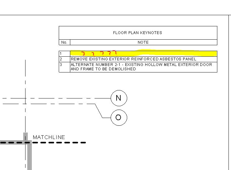

Heres a doosey for you all. There have been many posts about missing keynote text but I havnt run across anyone with my issue.
Is there a reason why keynote text would only not appear on 1 sheet?
Heres the setup. I have a schedule set up as a keynote legend which works on the majority of my sheets. This schedule is set up to "filter by sheet" so that only keynotes on a particular sheet show up. Keynote 1 is fairly universal to our sheets, and it shows up properly on every page except one. The keynote is properly tagged, same as all the other sheets. It just refuses to show text on one stubborn page.
Any ideas?
-Jeff

You don't mean "filter by sheet, you mean numbered by sheet, correct?  Can't really tell since you have 1,2,3 and not 1,9,10 or something like that.
http://help.autodesk.com/view/RVT/2014/ENU/?guid=GUID-3D8AC11C-B198-4904-AF56-5C3AAC8D0130
Remove the offending keynote and tag it again.  If that doesn't fix it, then the sheet may have become corrupted.  Delete the sheet and create a bew one and add your views and schedule.

I'm maybe thinking it could be a simple, "it got removed from the sheet temporararily" and needs the keynote legend pulldown reassigned.  OR the keynote is no longer on the sheet.
Otherwise, WW probably got it right.  Are you in 2013, 14 or 15.  I've noticed what worked in my 2013 gets corrupted in my 2015 files.
