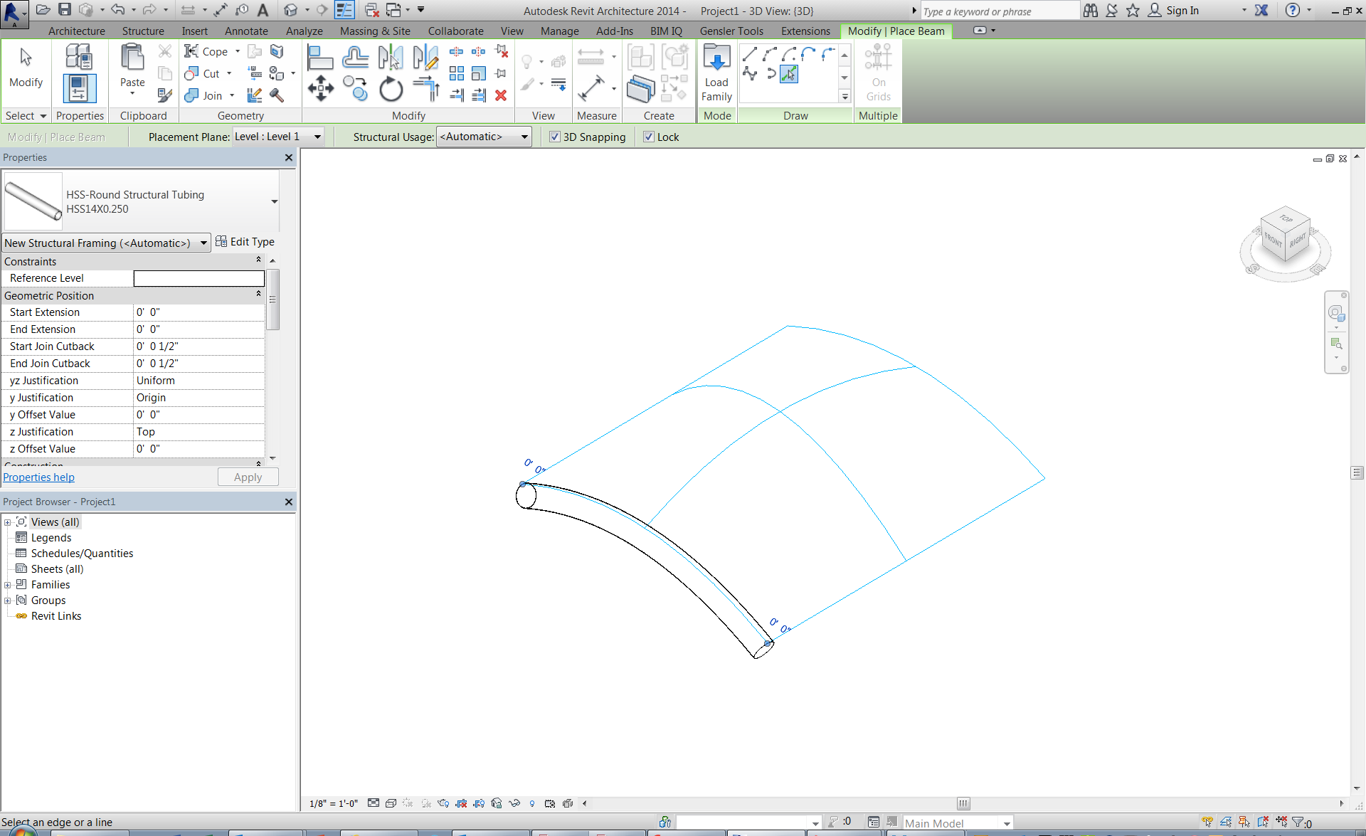

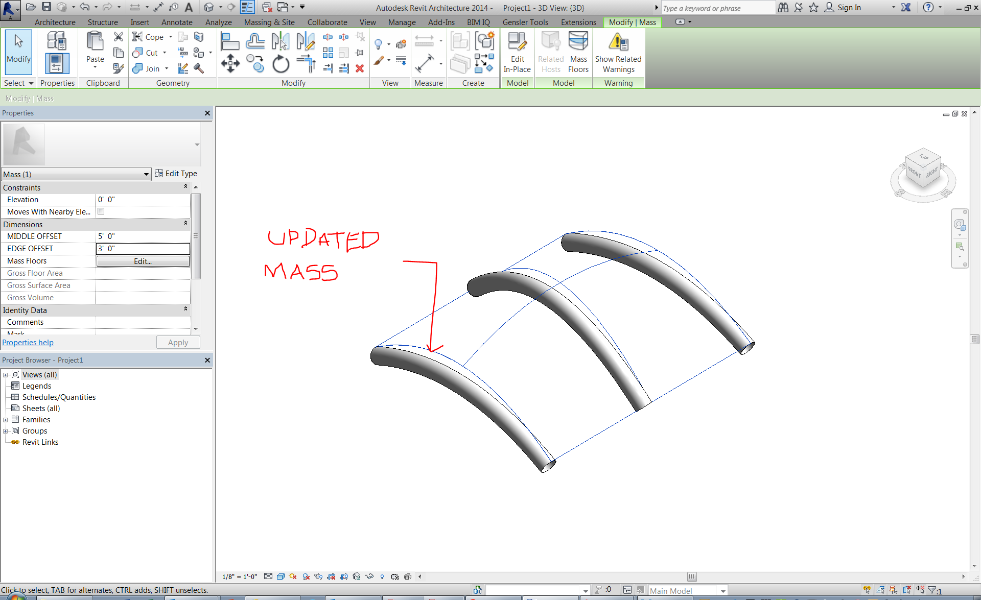

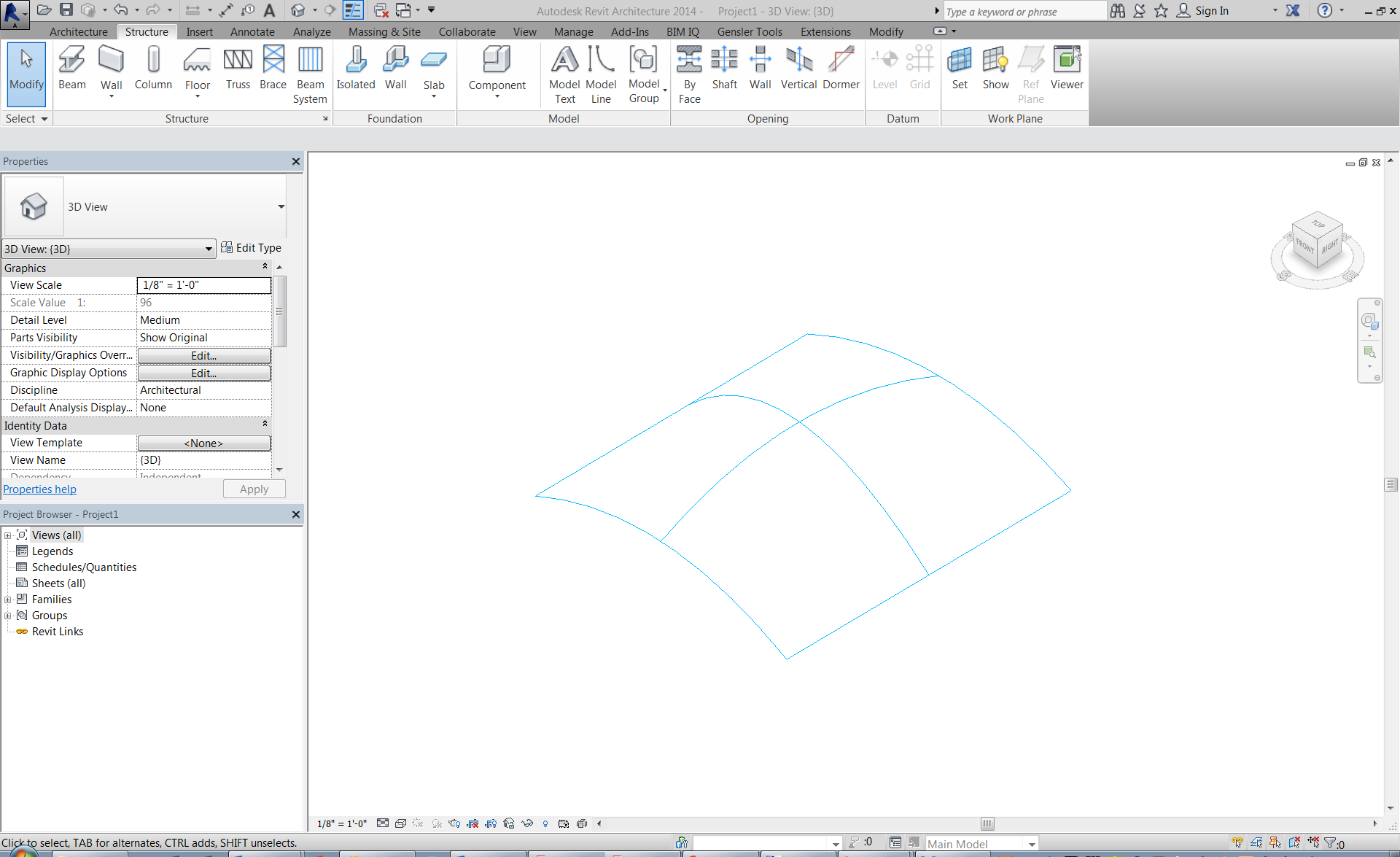

I think I'm missing something and I haven't quite found the answer: I want to build a roof that is based on a conceptual mass. From the mass I want to be able to attach structural framing. This part is easy. The part I'm not getting is that the framing that is apprently associated with the conceptual mass does not automatically update with changes to the mass. How do this?
Thanks

wa wa. Revit can't do. So sad. Some of the other feedback I received is to use adaptive components to sweep along the reference lines of the mass, which will update with changes. The drawback is that these do not contain structural attributes. The other suggestions I received was to use Dynamo, but I haven't tried it yet.
