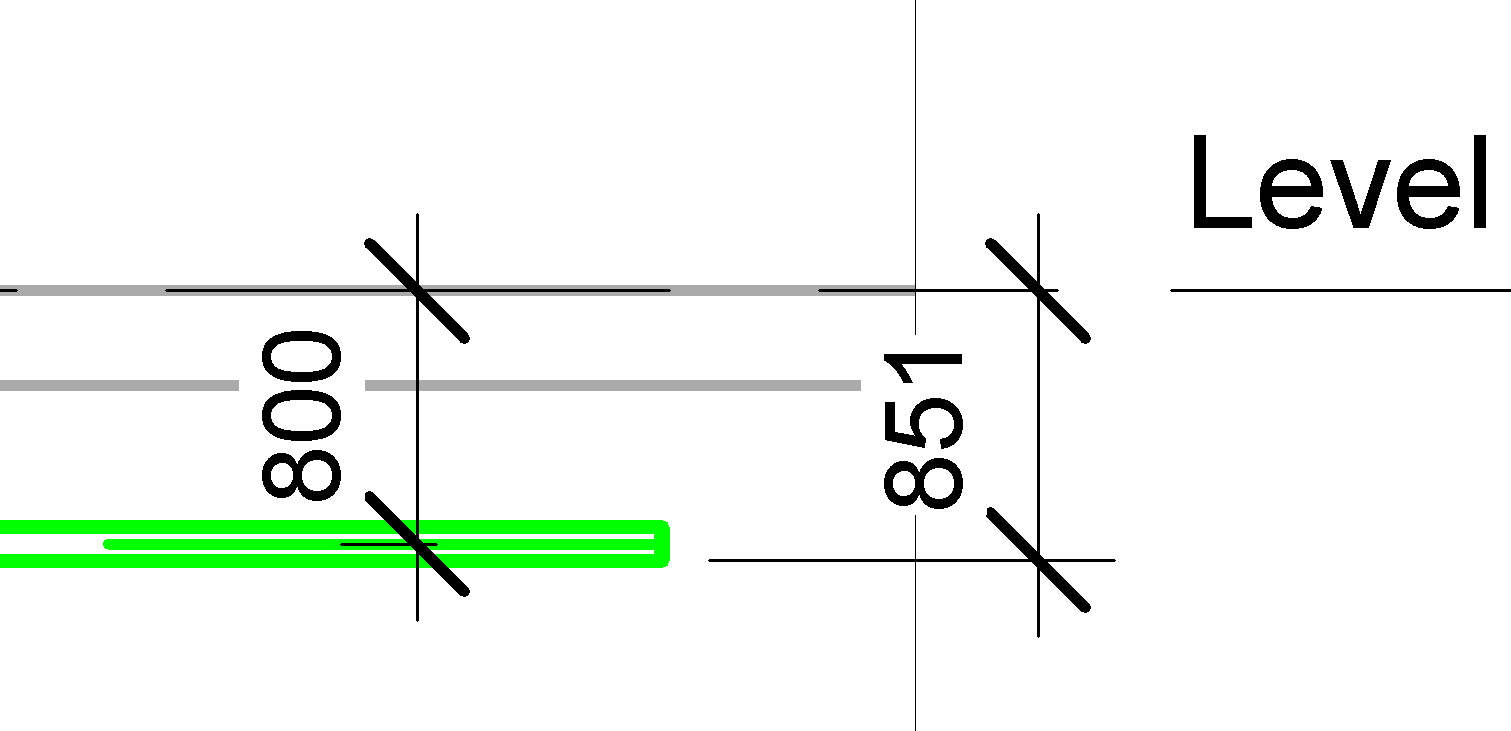

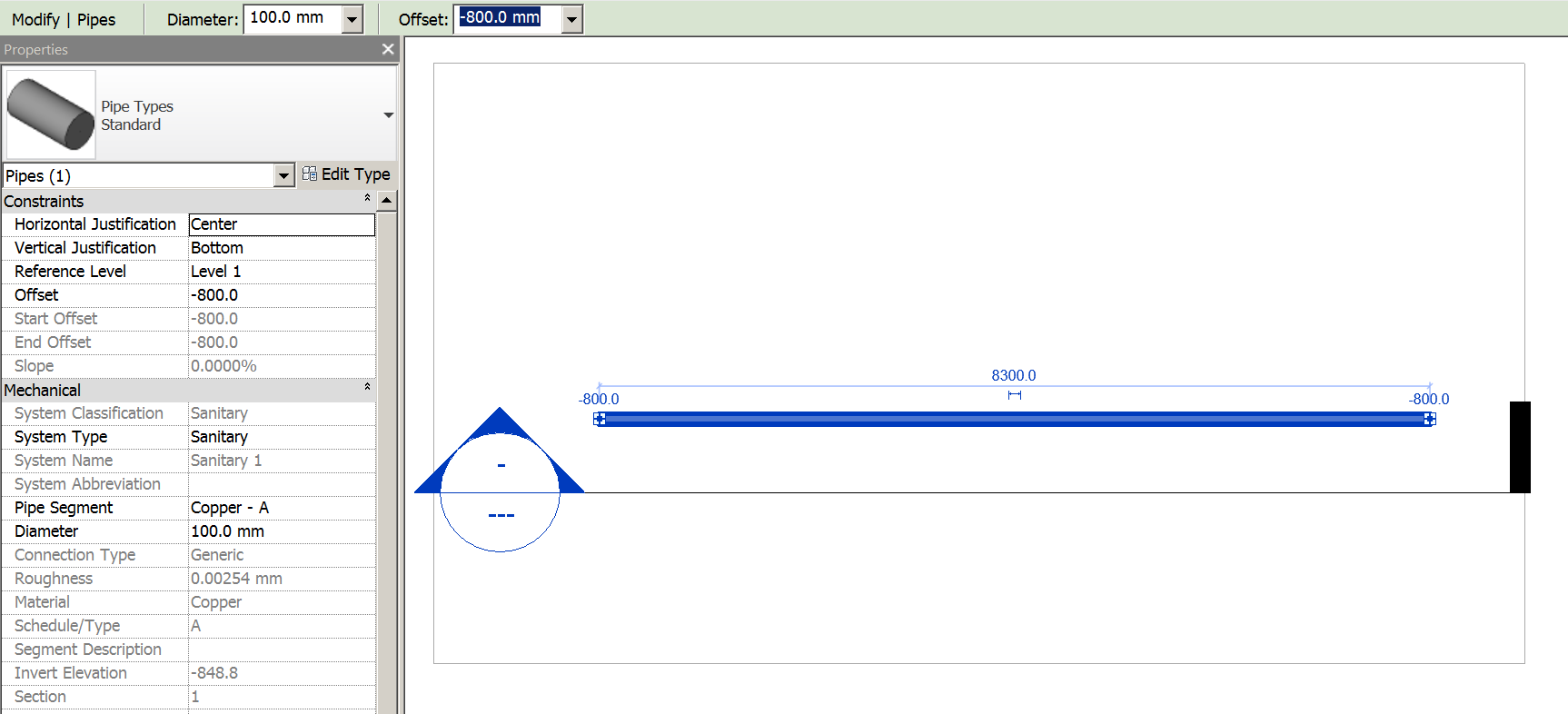

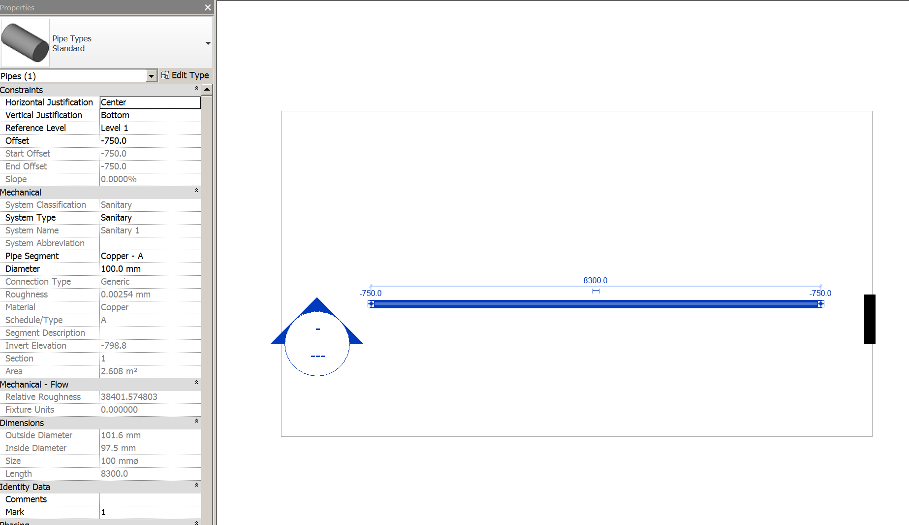

I am a newbie in Revit System. I use Revit V2014 when i create Pipe for SAN system. I set up VERTICAL JUSTIFICATION to Bottom and i setup reference level -800 from level.
When i check by section the dimention is show number in difference as i set it up. If i back to select Pipe to change to -800. The dimension in section as i create is shown in wrong value as i create in pipe property.
Have anyone can explain for me please how come is show like that.
Note: The image i attach is shown step what i did.
Thank you very much for your kind.

I'm pretty sure that since all pipes are centerline controlled that the offset property is always to the centerline.
http://help.autodesk.com/view/RVT/2014/ENU/?guid=GUID-54B16217-68F4-4F0C-928C-505690B44EFB

Thank you for your kind for explain for me. That is make me crystal clear for develop my skill.
Billion Thanks.
