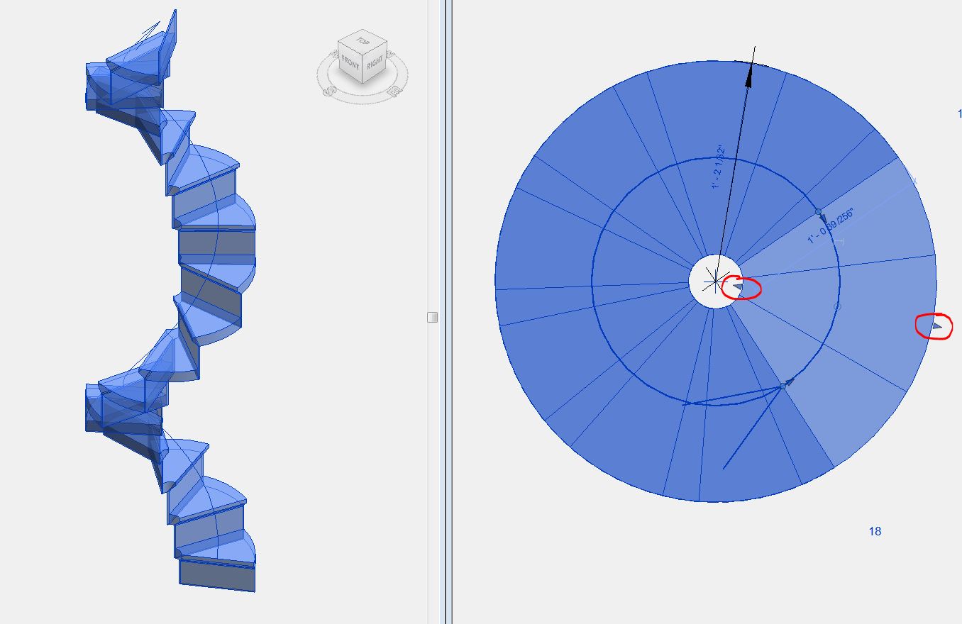

Does anyone know of a residential spiral stair manufacturer that has 3D Revit Models? I have made a spiral stair in Revit
(2015)- however the smallest diameter I can get is 7'6" and I wanted a spiral stair that is 5'6" in diameter. Appreciate any input.
If no 3D spiral stairs out there is there a way to reduce the diameter of the spiral stair I created in Revit? Any and all input appreciated!

It might be easier to just start with the spiral stair here:
http://www.revitcity.com/forums.php?action=viewthread&thread_id=8702

Adjust the size with the shape handles. Also, you might need to adjust max. riser height and min. tread depth parameters as well.
