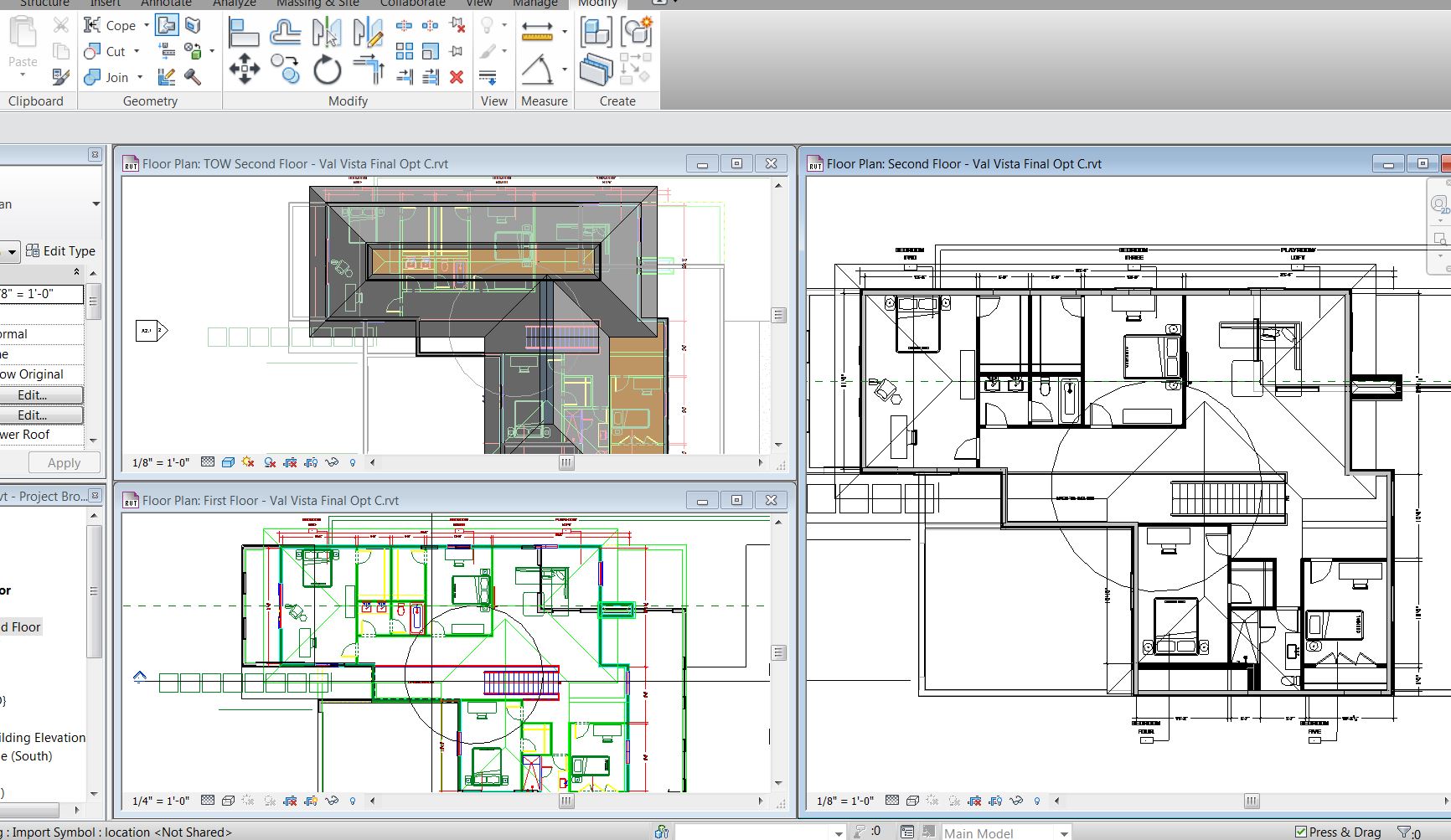

Check out the screen shot. The CAD underlay Im using is typical colored lines. Which is OK. Whats funny is that when I look at it from the second floor plan view its all black lines, which is nice. but the other plan views have it in color still, ie. the roof plan and the first floor plan....Ive not changed the original CAD underlay to be black lines, but Im curious how one makes it all black lines when its a color layer thing...I just now createed the second floor view. so Ive not made any changes to settings.

Was the file linked in each view separately? Because when you link a CAD file you have the option to preserve the colors or display black & white. If the file was linked so it was visible in every view, then I have no idea.
