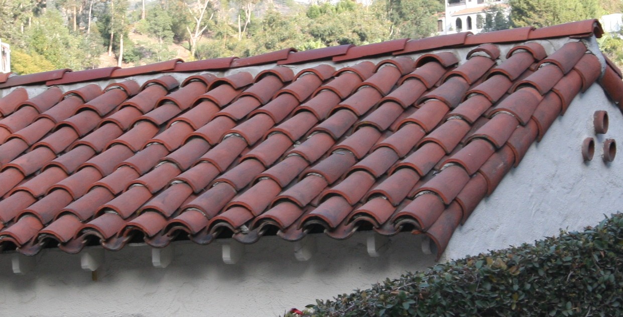

Has anyone ever created a Spanish Style Tile roof? I am getting ready to start one and would like suggestions. I am attaching a photo of what I am looking for. Any help on the process would be appreciated. Thanks. J

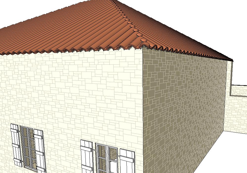

Agree with JSavage,
It works like a charm. i also use that method to create rafter and purlin system too and working well.

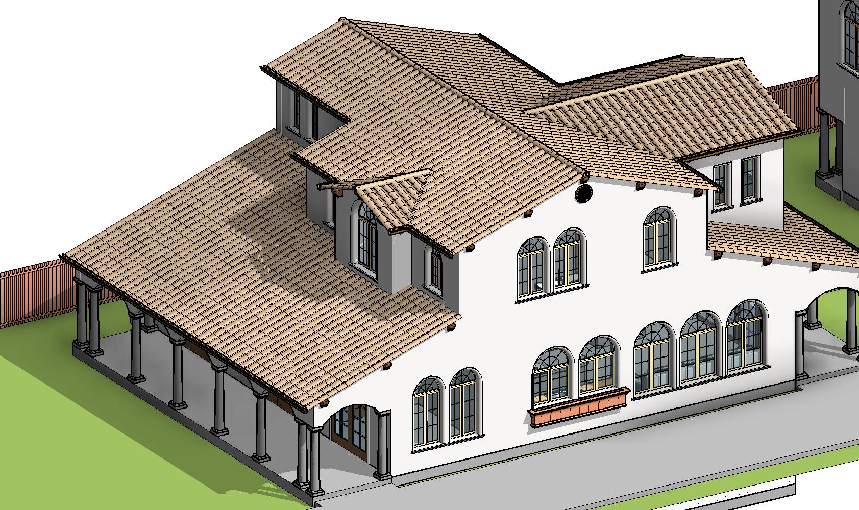

ghost16383  can you provide step by step instructions for creating the Spanish tile roof shown in your post.  Your image file is more detailed than jweber's which shows a simple extrusion witout the segments.
