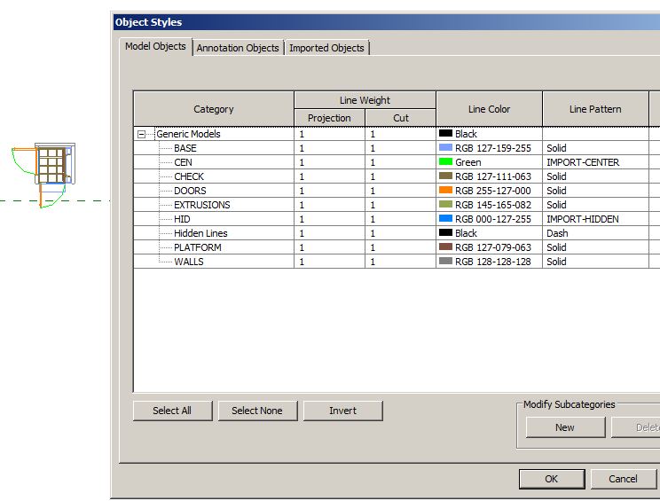

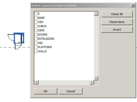

Not linked in families.... exploded in families.   Then the linetype is defined in the family and is loaded into the project each time the family is loaded..... Even if the line actually still doesn't exist in the family.
Attached:
  1. Showing unexploded CAD layers in Family.
  2. Showing linetypes created from exploded CAD.

It will not be exploded CAD in Families.   All linetypes created there will be in the family category and are not available in the model unless you are modeling in place in that same category.
What doesn't make sense is the multiple linetypes of the same name.
Send this to Autodesk please.
