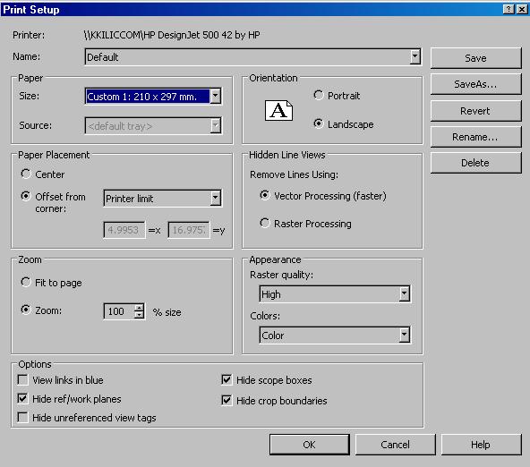

how can i change custom paper size?..i couldn't find in the printing interface ..thnks

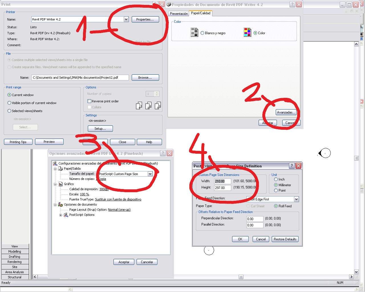

Let's see! File -> Print At Printer section press button: Properties... Press button: Advanced And finaly choose Paper size: Custom and there you have the chance to change the size. So easy, so easy...!

i still can't see any paremeter to change..there are 5 custom size by default (210x297) and no chance to change them...... Post edited on 2006-03-16 08:26:22

If you had followed my instructions, you would not have had problems. The printer section is at the first window that opens when you press Print. Hope this helps!

Use this image guide.(Some parts are not in english but in spanish (don't worry it's not important)).
