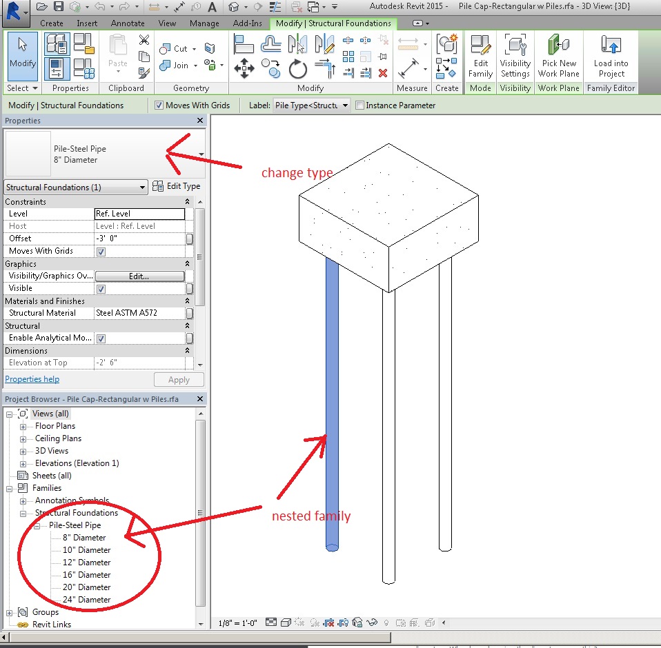

The pile family I have has a nested pile family - not an extrusion in the pile cap family so what did you do?
Their are multiple types of the nested pile family in your library so just load the correct type and switch the types in your pile cap family.

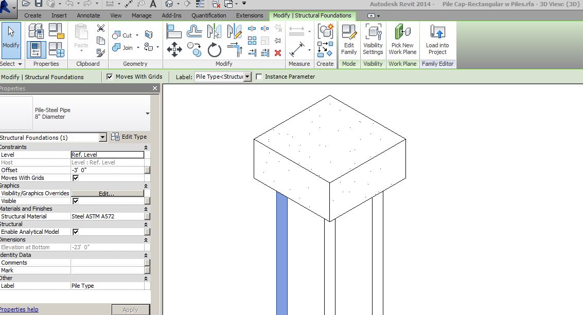

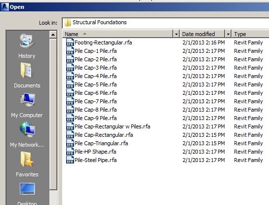

Sorry but unless you are using a different Revit than 2012,13,14,15 .....then you are not using a stock family.
My images are Revit 2014
Edited on: Thu, Feb 5, 2015 at 8:40:49 AM

Thu, Feb 5, 2015 at 9:07:25 AM | Pile caps standard revit families
Either you are NOT using the standard family or you are deleting and replacing what was provided.   Look at the attached image of the 2015 family.   The piles are a nested family - change the type!
Reposted image
