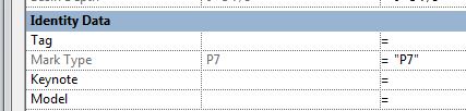

Locking the text in the plumbing fixture tag can be done if you're talking about tagging by Type, but if your parameter is an instance it can't be done. I've made our plumbing fixture library and tags based on fixture type and placed the type designation in the formula portion of the parameter (using quotations), this makes it uneditable in the project and hard-codes it into the family. One would have to edit the family to change the parameter.

Thanks Gyvven, that is exactly wha I was looking for!!
