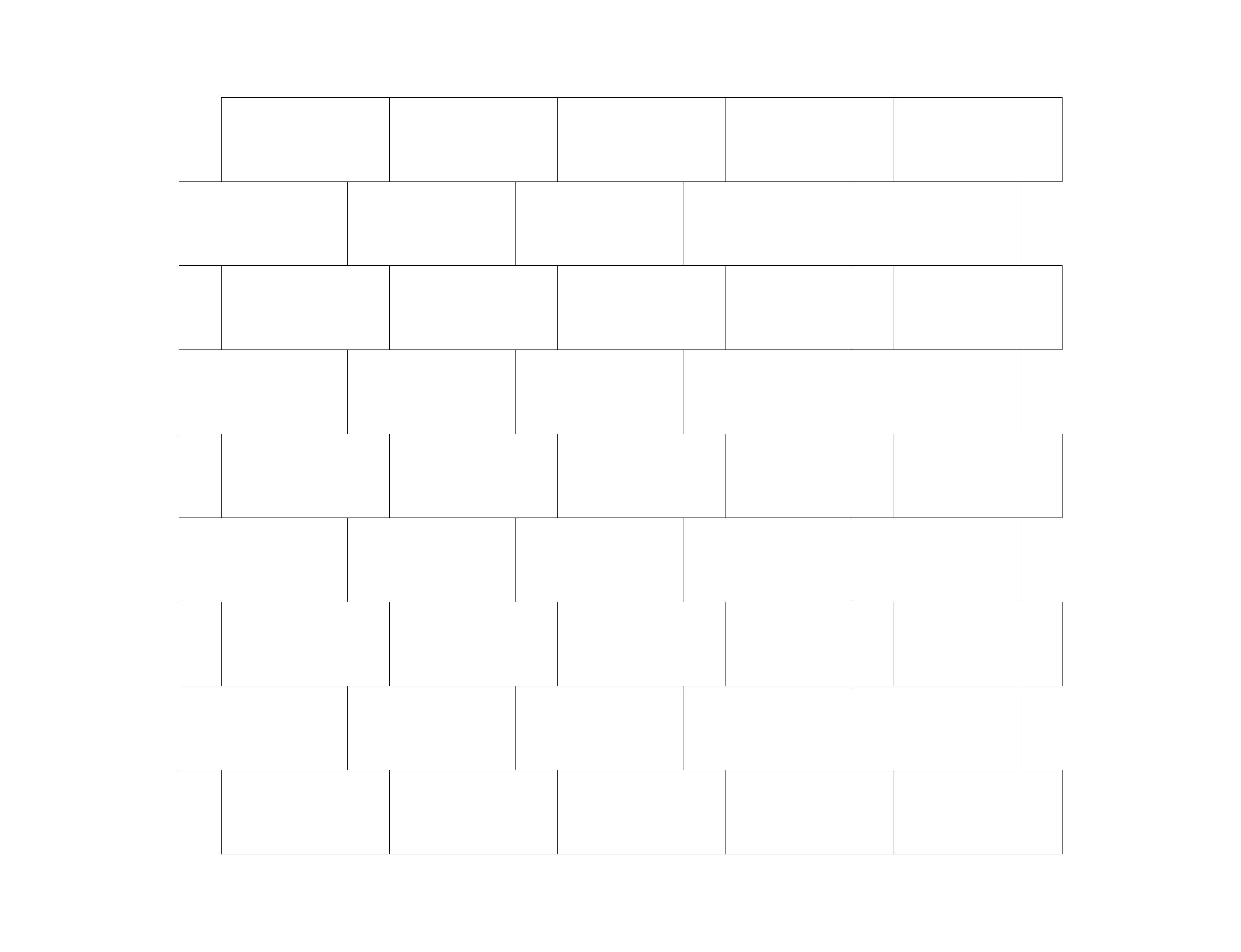

How do you go about creating a custom hatch pattern like the following without using hatch editor plugin?
It's a tile pattern.  The tile is 12" x 24" and I would like to stagger the course on 1/4 interval (shifting 6").
Thanks in advance

How to create a hatch pattern is explained in revit pat file (revit.pat) located C:\Program Files\Autodesk\your revit version\Data
Save the following code in the Notepad as a .pat file and import to revit.
*12”x24” with 6” shift running bond
;%TYPE=MODEL
0,  0,0,  0,12
90,  0,0,  0,24,  12,  -12
90,  6,12,  0,24,  12,  -12
