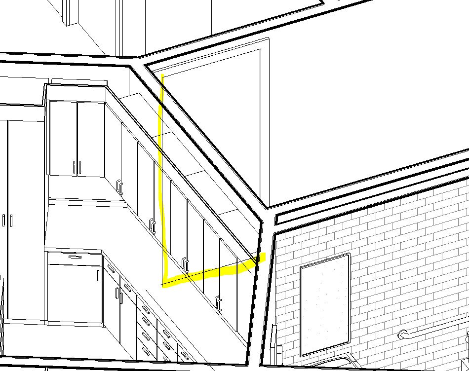

Does anyone know how to remove lineweights?  For a presentation, some lineweights in my model were changed using the lineweight (LW) command.  I need to create some images from my 3D view, but those altered lineweights show up through the model (even through walls they are supposed to be "behind").  The only way I've found to remove those lines is to give them a lineweight of 0, but then they don't show up in other angles.
In the attached image I've highlighted the lines in questions.  I shouldn't be able to see them through the wall, but because the lineweights were changed now they show up regardless of their relative location.
Any suggestions?

Use the LW tool and use the <By Category> to turn them back to how they were.  You can also drag the ends of the lines as soon as you change them there will be a blue grip you can drag.
Wed, Jan 28, 2015 at 9:31:49 AM | Revit lineweights
I doubt those were linetool lines.   I bet they are really lines (3D).
