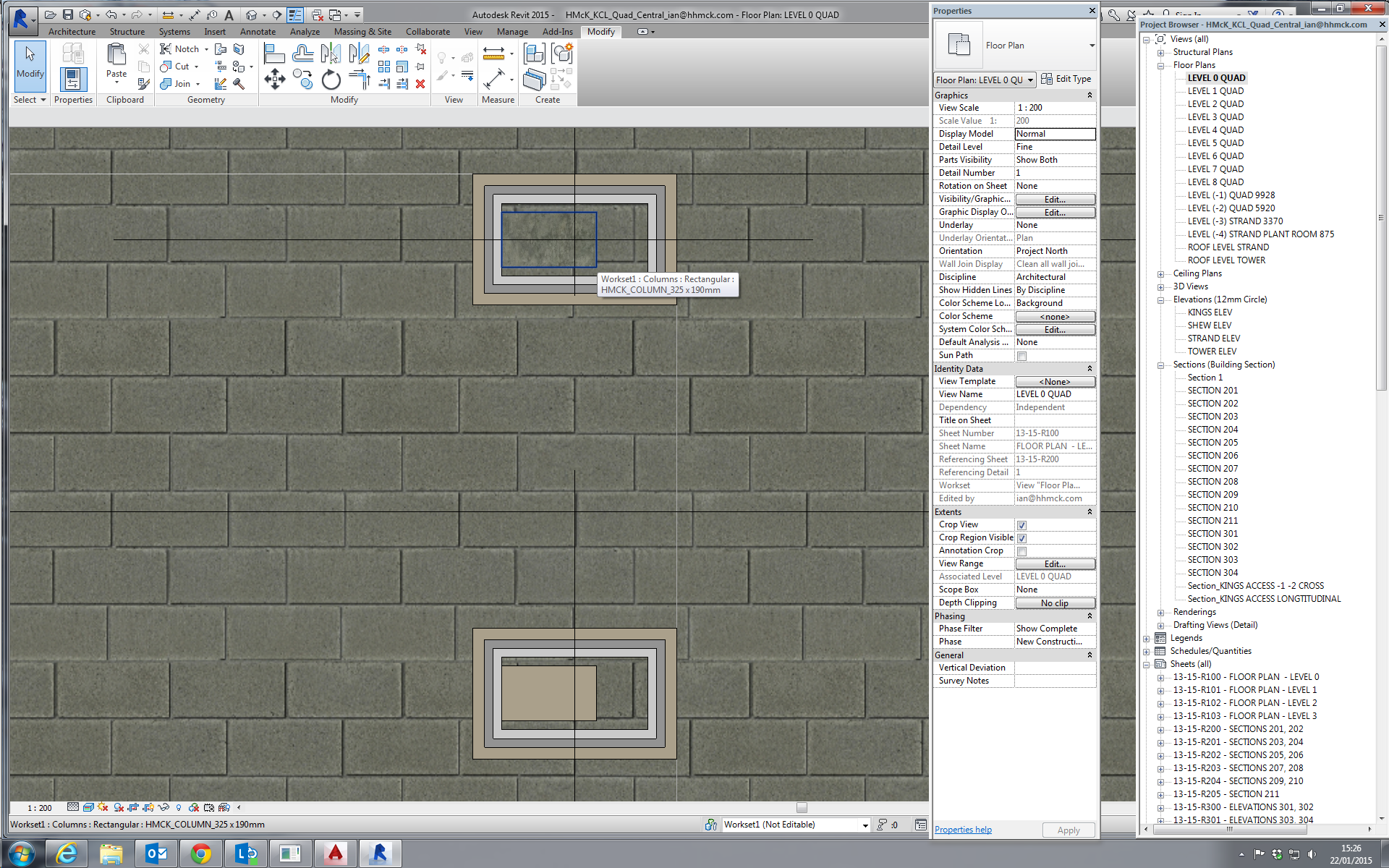

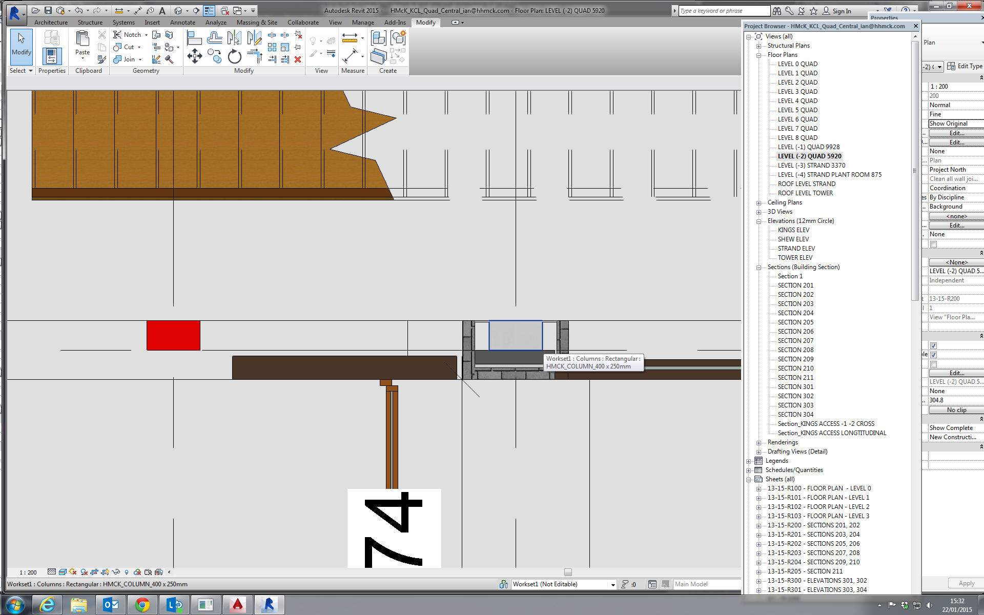

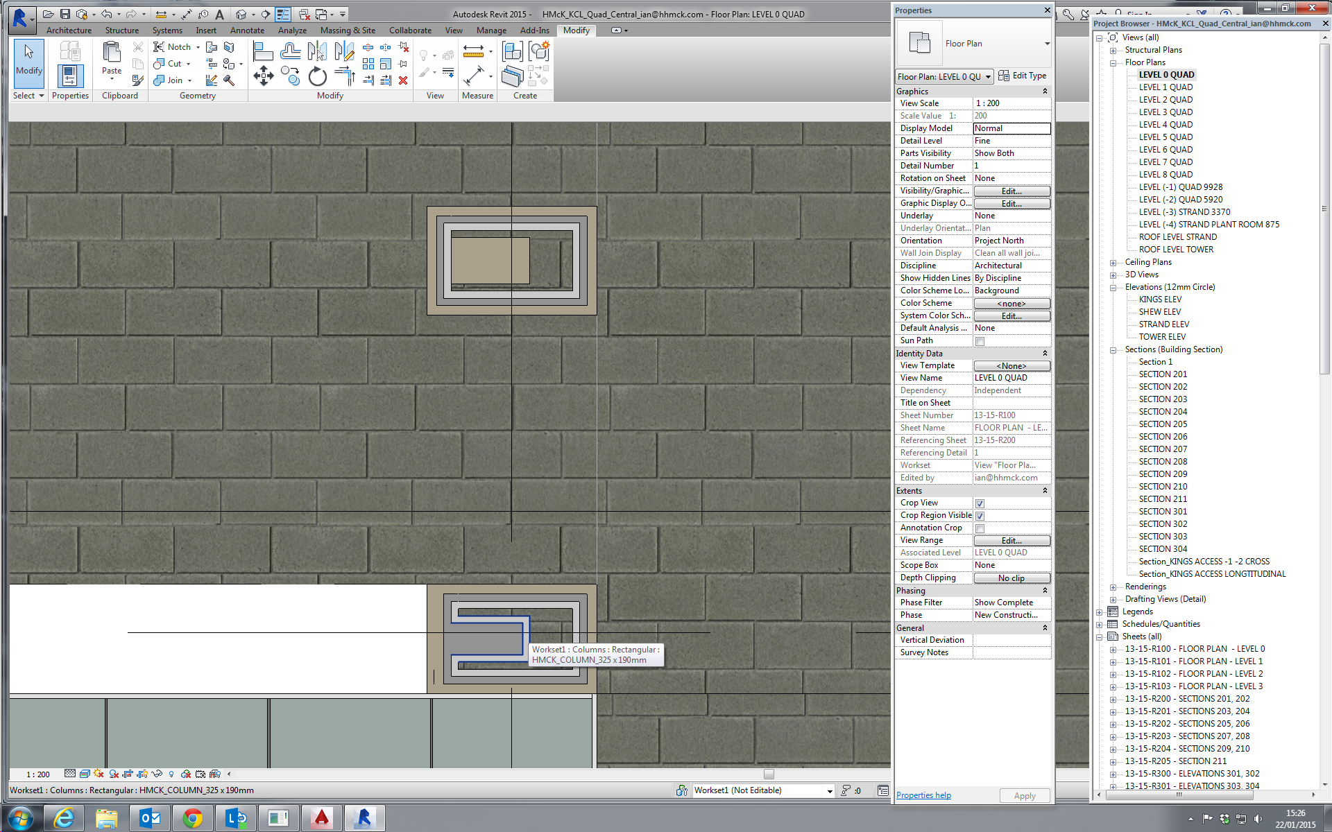

I HAVE BEEN PLACING ARCHITECTURAL COLUMNS INOT MY MODEL. THE MATERIAL IS SET TO CONCRETE BUT WHEN I PLACE THEM, THEY SEEM TO TAKE ON THE MATERIAL OF THE ADJOING WALL.
I CHANGED THE COLUMN MATERIAL TO DEFAULT FORM RED TO MAKE THE COLUMNS CLEAR ON PLAN BUT THE PROBLEM PERSISTS....
SEE PRINT SCREENS ATTACHED.
PLEASE HELP!

got it
architectural columns are designed this way to do this
need to use structural columns to avoid this

Although I can't find where it tells you this in the HELP, architectural columns will always assume the material of a wall they come in contact with.   They really act like a pilaster in that case.  If you don't want that, then use a structural column.
