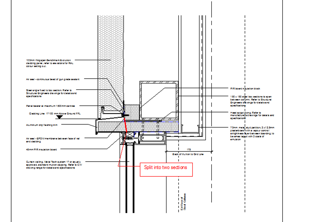

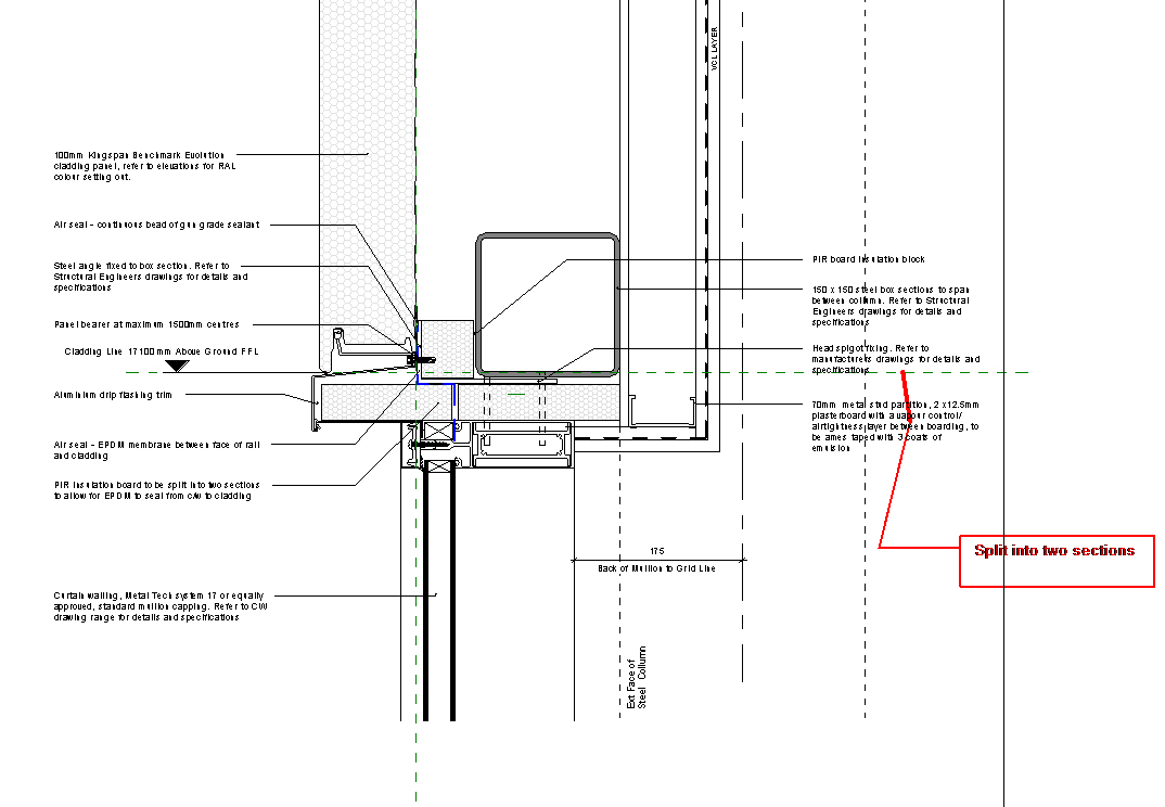

I have exported a variety of views from Revit to use within a group discussion. Using Autodesk design review to add comments and lines, once completed I saved as Dwf and intended to import this back into Revit.
When I import a variety of sheets, the notes dont align, where shown on the marked up dwf. As these are pinned you cannot adust these notes, and really, aligning each sheet defeats the purpose.
Has anyone come across this before?
The first markup is located correctly. But the rest of the sheets the mark ups are way off where they should be.

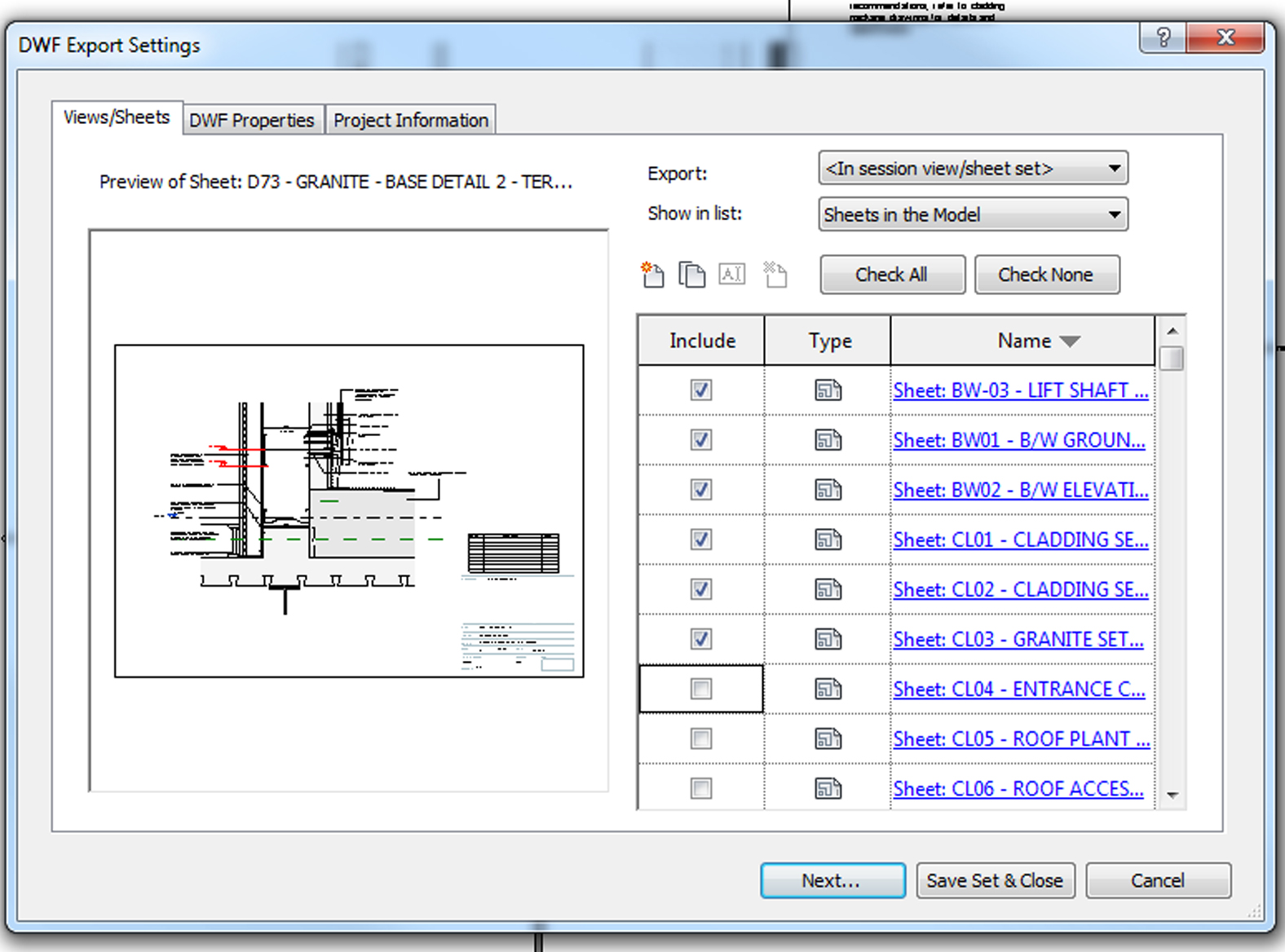

I have not had any problems.   You exported to DWF all the sheets (not views) at the same time - correct?

I have attached an image to show you how I have set up the export.
Also, added image to highlight the effect from Autodesk Design Review and Revit.
So to reiterate once exported, I have drawn over and commented on several sheets in Autodesk Design review. When I import this back in as a dwf markup to Revit the additional notes go onto the allocated sheets but are not aligned correctly.

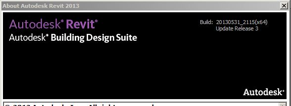

So by up to date, you mean you have all 3 updates installed for 2013 - correct?- see image
We have seen too many users who say they are up to date and they are not.
Thu, Jan 22, 2015 at 9:46:37 AM | Dwf Alignment Issues
Graeme6226
Joined: Tue, Sep 20, 2011
0 Posts
5 Stars: 1 Votes
Yes, I have this exact information in this dialouge box.
All updated have been installed.
