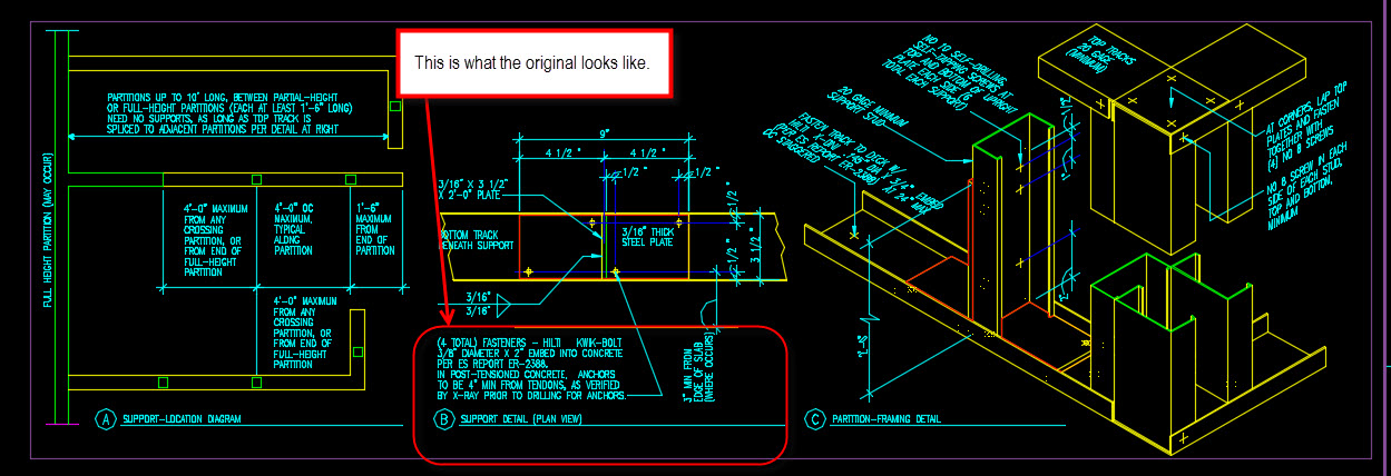

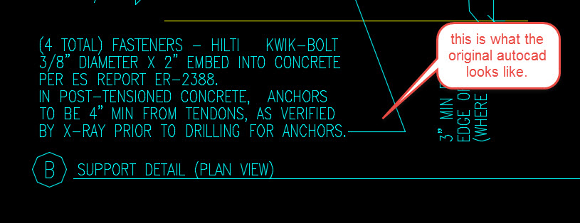

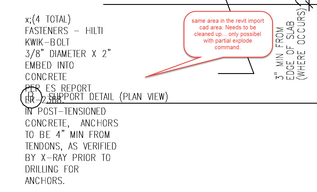

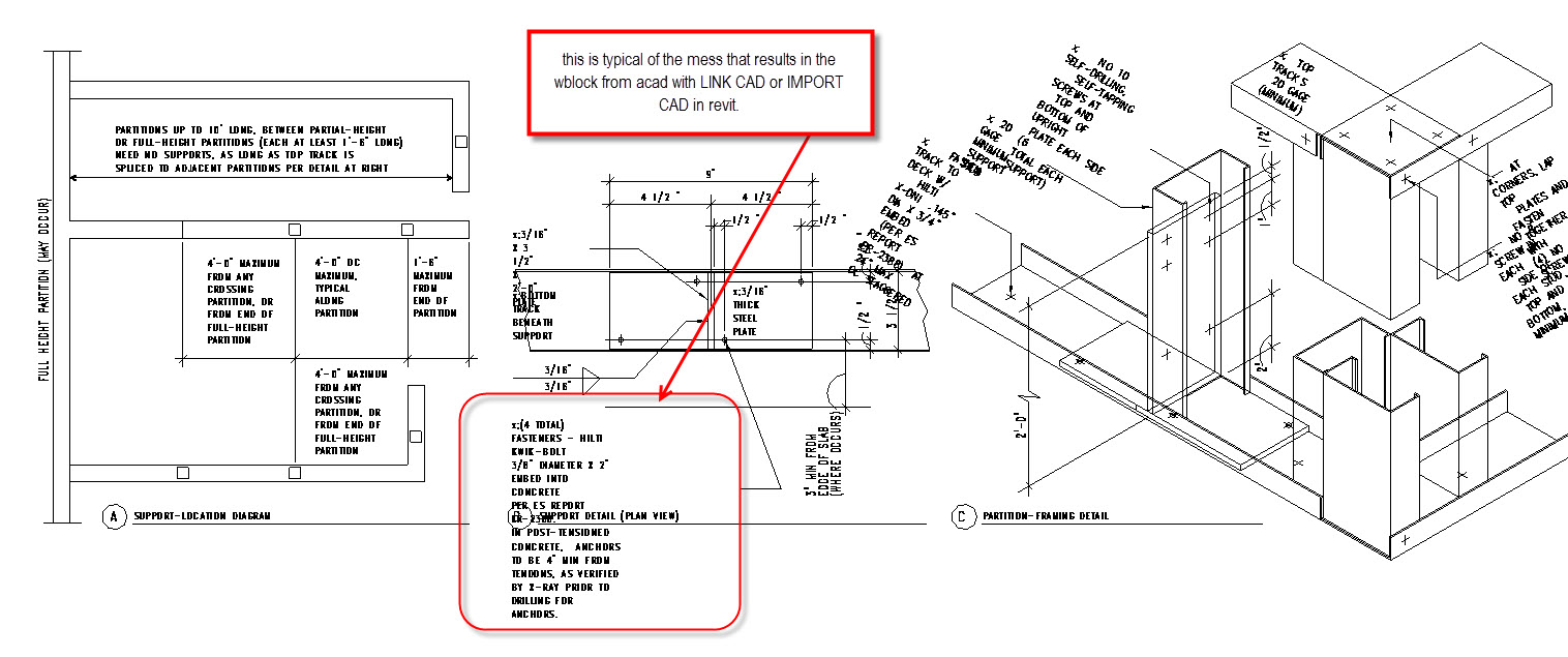

plus the drawings that come in are always a bit of a mess ... need cleanup via partial explode.  see examples
136709_2015-01-1612-14-03.jpg136709_2015-01-1612-13-55.jpg136709_2015-01-1612-10-48.jpg136709_2015-01-1612-10-34.jpg

I think the problem is probably caused by the text in CAD being SHX instead of truetype fonts.  SHX is converted to a truetype font upon import.   But you can control this.   Read this in your HELP:
http://help.autodesk.com/view/RVT/2014/ENU/?guid=GUID-87119589-ADE4-41AD-A796-3EB3C1DDDA82
Clean them up in CAD changing the font there or build a library of true Revit details by importing into a cleanup project.

The font mapping did the trick, THANKS.  strangely, the text is now spaced correctly, but still looks visually like the acad sources "romans" font, not
the arial font i mapped it to.   but it works, so I can leave it alone.

i've also noticed that the Import Cad Formats/import units has to be selected as "feet" for hatch patterns to come in correctly.
And I don't know why, but text comes in with "x;" at the beginning of every entry like this... http://goo.gl/rQtj3y     I have mapped the .shx text file.
