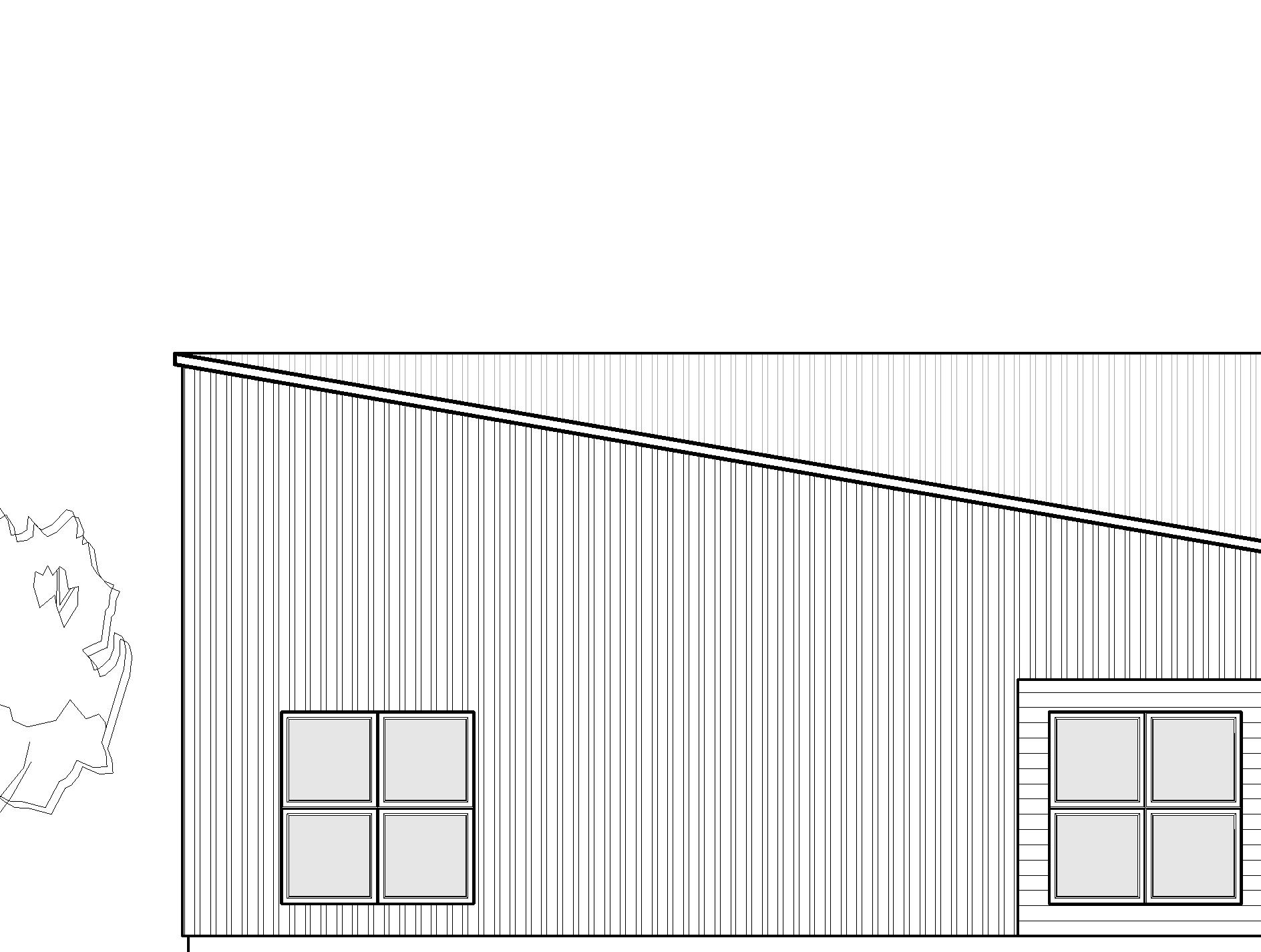

Hi Folks,
I have a project where the roof material is the same as the wall materials. It it metal sheet.
In elevation view, the pattern of the roof is grayed. The roof is sloped.
The wall pattern are ok, black. I checked objects style, view override, etc and everything is set to black. Normaly, roof pattern should display and print black. Somebody knows what's happening?
Please see attached image

Also, the drawing scale is 1:100. The roof surface pattern lines that are gray turns black when I set the scale to 1:20 or 1:10.....

Patterns that are no longer normal to the viewing plane are usually lighter depending on the angle.  If the pattern is too intense for the view scale, it may even disappear.

Thanks you. Is there a way of controling this?
Thu, Jan 15, 2015 at 1:48:15 PM | Sloped roof surface pattern grayed.....Revit 2015
No
