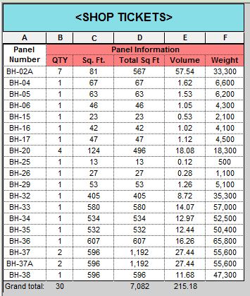

Has anyone come up with a work around to get a total number of mark numbers in schedule instead of total number of pieces?  I have a schedule of piece numbers and would like to know how many piece numbers are in the project.  However, when I calculate the totals in the schedule it gives me the total number of pieces.  Since some of my piece numbers have multiple instances the total piece numbers and total number of pieces are not the same thing.  All the work a rounds I have tried have not worked because revit evaluates each piece individually then totals them up.  Hence the reason you cannot use count in a formula.  See the attached file for my sample schedule.  There are (19) Panel Numbers but the ground total of pieces is (30).  I’d like for my schedule to display a count for the mark numbers along with the total piece count.
