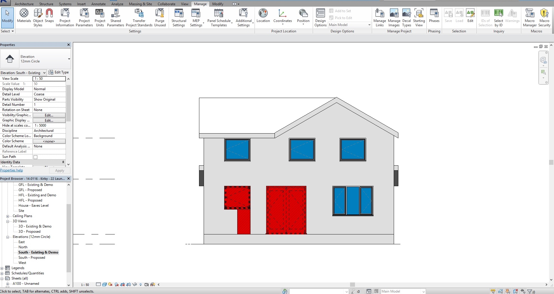

I have a query regarding setting up graphics for elevation views. I'm looking to introduce BIM to my current company, we have to show a lot of existing and proposed elevations so I've learned a bit about phasing however I have a query regarding the attached screen grab

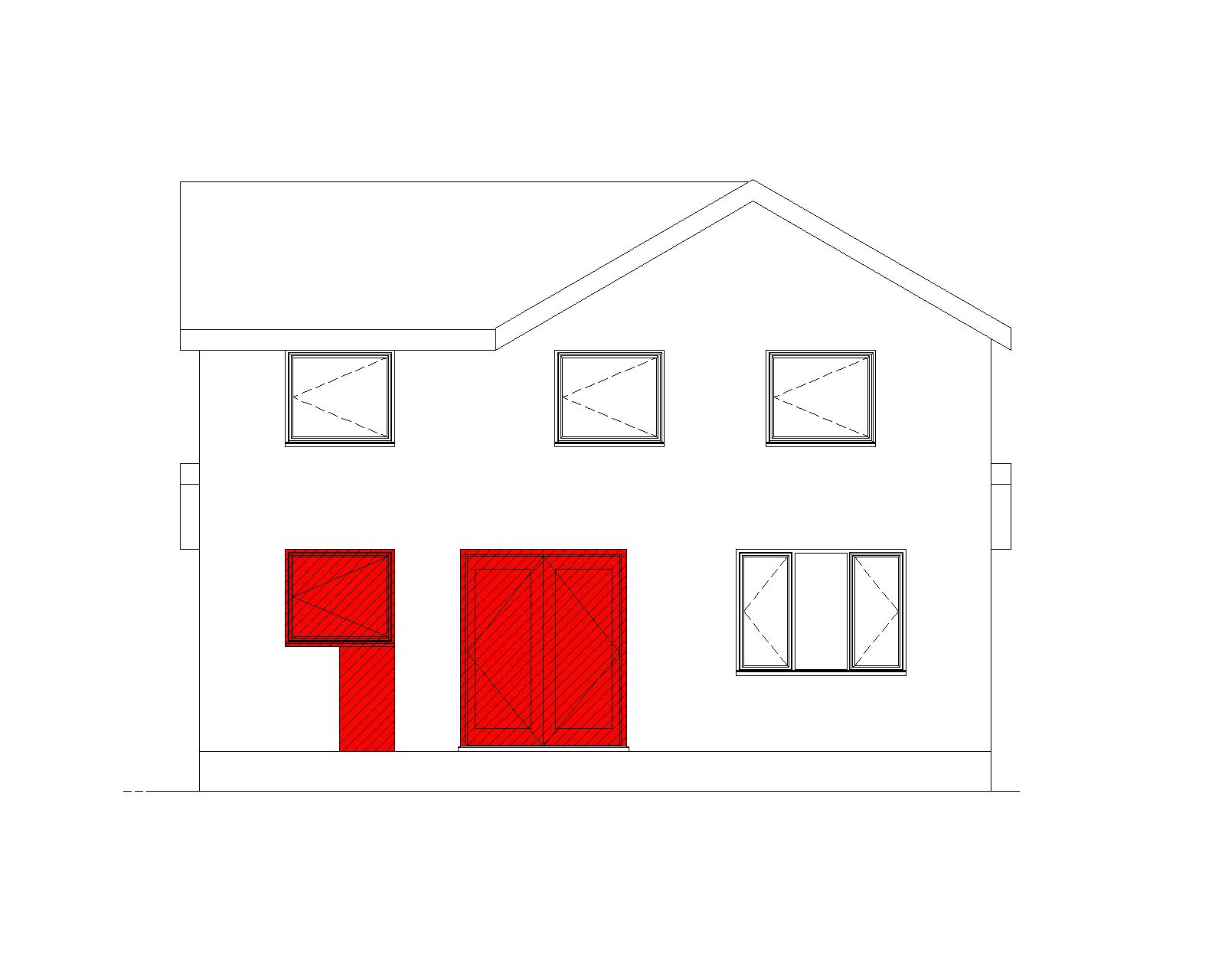

Is it at all possible to show all my existing elements with a black outline and no infill? FYI - the windows and house wall are 'Existing' however you'll not the window glazing is Blue and the walls are a light Grey. Ideally I would have all existing items without any hatching, just a simple black outline. If I swith to 'Hidden Line' then I don't get the colour I'm after for the demolitions or the proposed works. I have attached the same project but with a screengrab taken from the same project which was drafted in AutoCAD. This is what I'm looking to achieve.
Hopefully the above and attached show what I'm looking to achieve.
Mon, Jan 12, 2015 at 9:02:34 AM | Phasing query - How can I tweak my 'Shaded' elevation
Read your HELP on view filters.
http://help.autodesk.com/view/RVT/2014/ENU/?guid=GUID-B451C74B-9214-4974-9A49-2B46A9F6D822
http://help.autodesk.com/view/RVT/2014/ENU/?guid=GUID-FA7B0AD9-4F0F-4405-9DF7-35D30D7CBE7B

Thanks for this, much appreciated.
