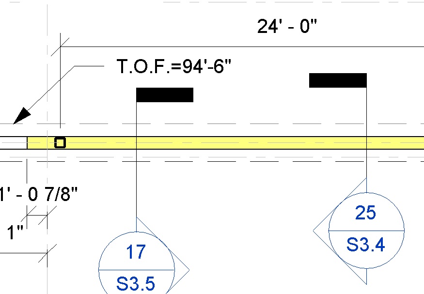

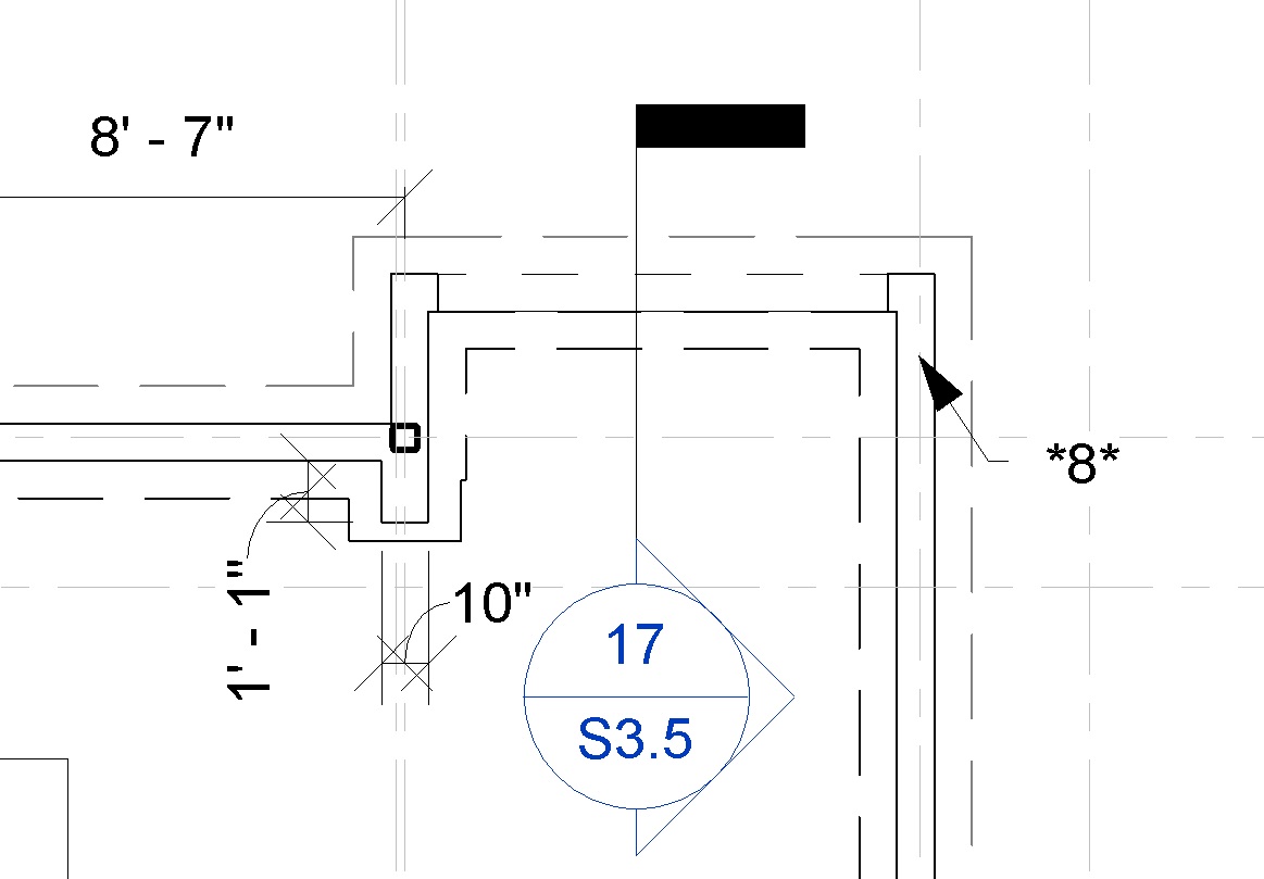

I am using a hatch to denote wall height on my exterior foundation walls. The only issue I am having is showing blockouts at the Doorways. The border of the hatch is shown as a solid line and i need it to be hidden in order to show the blockout. Below are two images, one of how I want the Blockouts to look, and the other with the Color is where I am Having issues. Is ther any way to fix or change this? If I could make the border of my hatch hidden, I could dray in solid line where nessisary.

If by blockouts, you mean the wall is held down for an opening, then is the opening modeled? If you cut through the wall, it will be hatched.  If you cut through the opening it will not be.
Maybe you need a plan region to have a different view cut elevation here.
