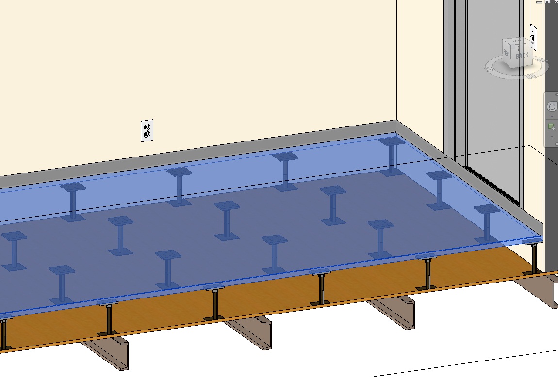

I'll bring this thread back to the top because I had to include this type of floor on a project today. We're getting the system from these guys: http://www.asmproducts.com/ and was glad to see that they had BIM content available through ARCAT http://www.arcat.com/bim/clients/asmmodul.html?coid=40458
I didnt' use the panel elements, just used a typical revit floor to represent the panel thickness. The pedestal and stringer models come in real handy for scheduleing quantities and just looking awesome.
