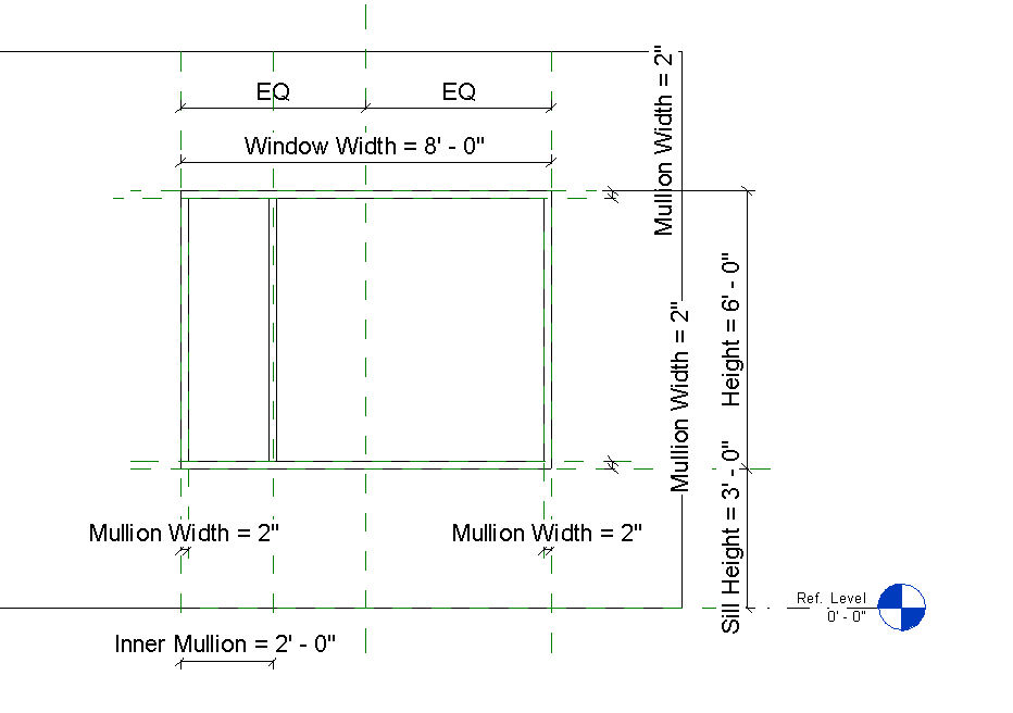

I'm having a problem with this family and I hope I'm not being too picky but there seems to be no solution!
This is for a simple window family. It has two panes and a mullion that's placed asymetrically. I placed a Instance parameter to the mullion so it can slide back and forth, but it also adds another grip to the reference place which moves the entire family. Is it possible to get rid of the other grip somehow? I only want the mullion to slide.
Can anyone help me with this?
Thanks so much!

Is this what you're looking for?

Yes! Thanks. So if I understand correctly, when you set a plane as "not a reference" it just means it's not a reference to the family's placement in the project? Anyway, thanks.
