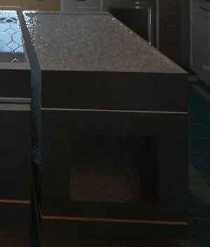

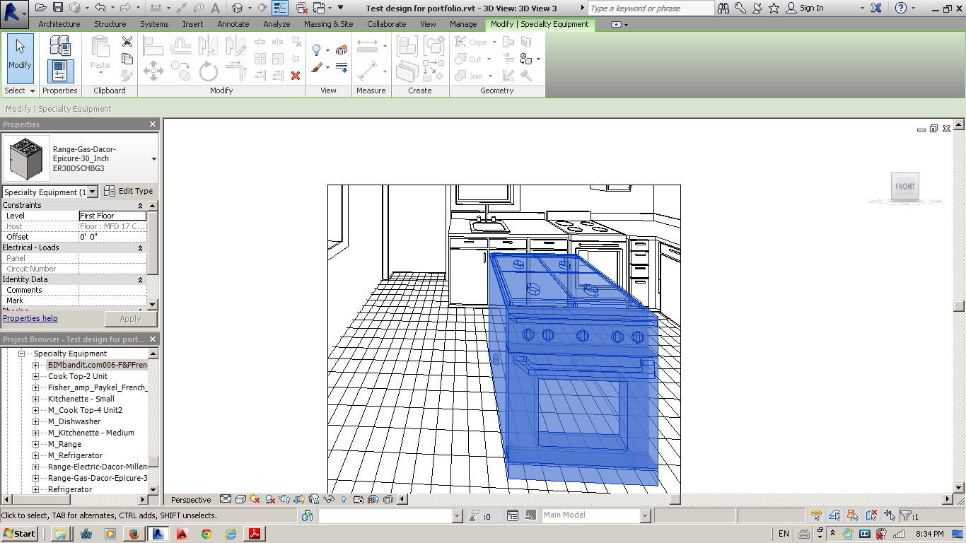

Why isnt my Range top, knobs and door handle not showing in my renderings? After I load the family and select it, I could see that the Range Top, knobs and door handle are there (see attachment). For some funny reason after I render it (see attachment), it looks like as if the Range Top is hidden in a white block and the knobs and door handle disappeared.

You need to set your view to fine detail level.

Oh my god, it worked!!!
Thanks a lot pijpiwo!!!

God has nothing to do with it …lol, it’s just the way this family is built.
...and it’s quite easy to change it to work in other detail levels as well (if needed).
